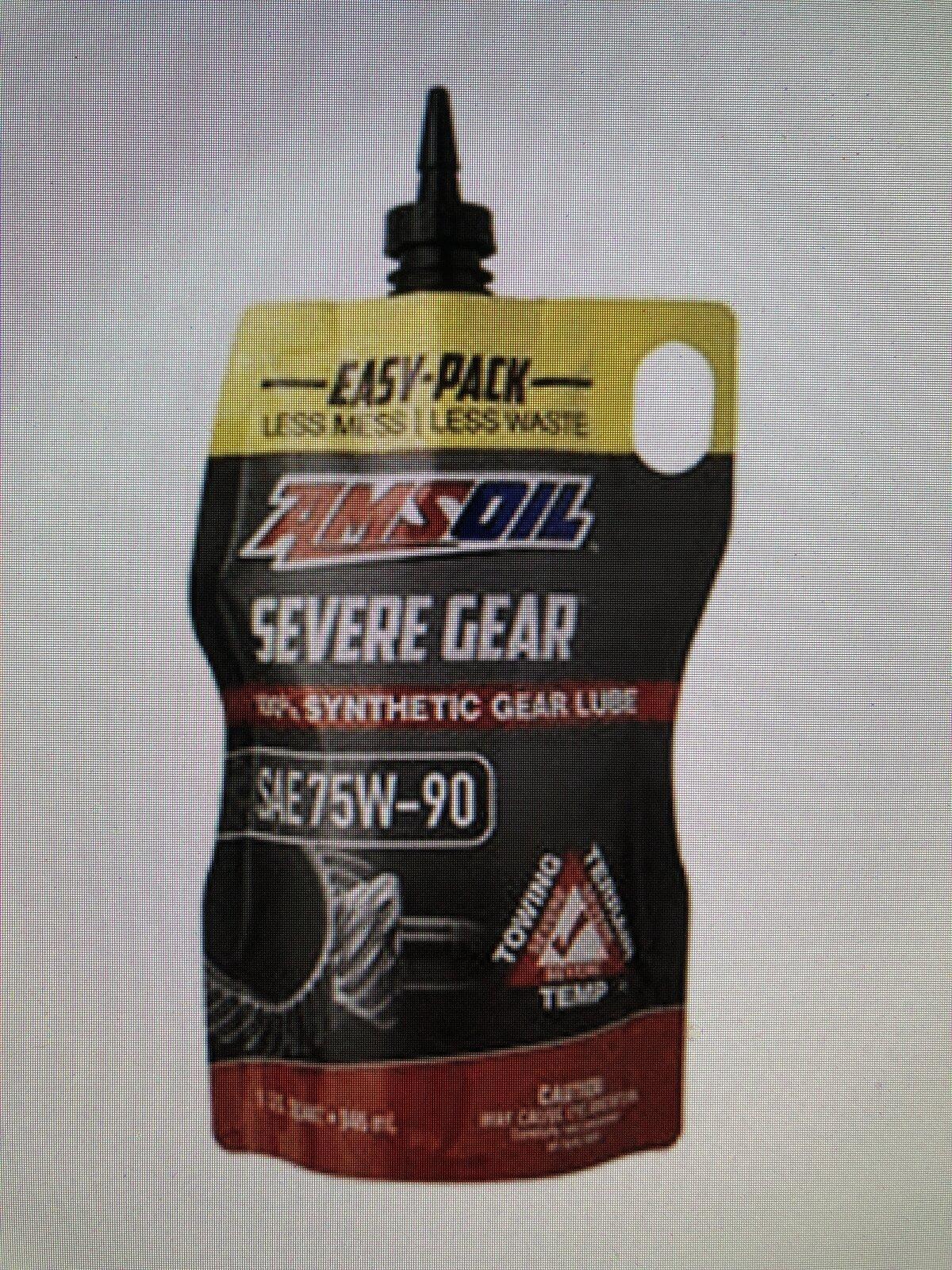

Personally I would dump engine oil at 2-3,000 miles and replace with "FULL" Synthetic. Synthetic is in your engine from the Factory. Use FleetGuard Stratapore filter or Donaldson Blue or AMZ/OIL EAO80.
Rear diff I would dump at the same time and replace with this!!!

I would do the rear diff earlier than recommended, probably with the first oil change or 10-15K which ever is later. I did mine at 15K and it was looking pretty bad. Front was like new.

I agree with the others on the gear lube. I changed mine at 15K and should have done it sooner. It’s not great fluid from the factory.
I dumped my factory fill at 5000 miles refilled with the Amsoil Signature Series Max-Duty Synthetic Diesel Oil 10W/30 and an Amsoil Ea080 Filter. Been using Amsoil Synth oil and filters since 05'. Going to do the diffs soon, real soon.. Seems the the folks at AAM can't really set up ring and pinion gears correctly anymore.... Both my 18' and 19' had/have excessive play in the rear end.
