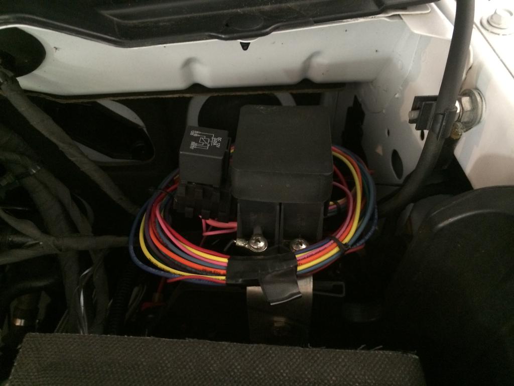

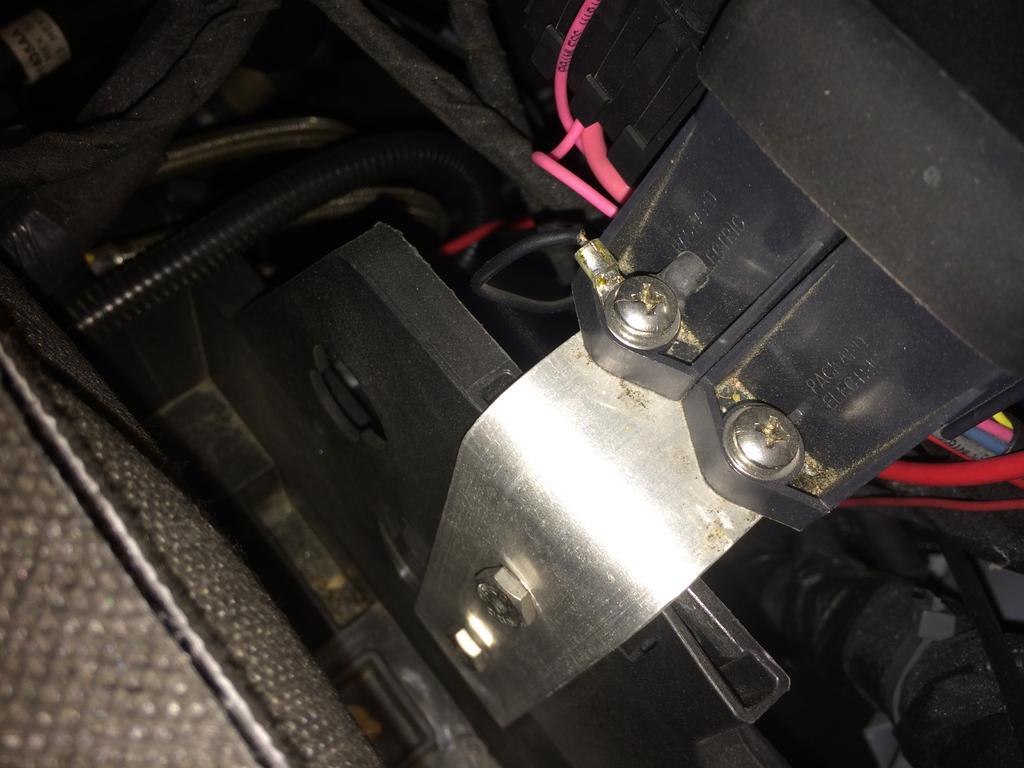

For a touch more, you can install an sPod system and significantly reduce wiring and worries (of shorted power wires around the firewall) along with extra circuits ready to do whatever you want.
This is one way to do it.
