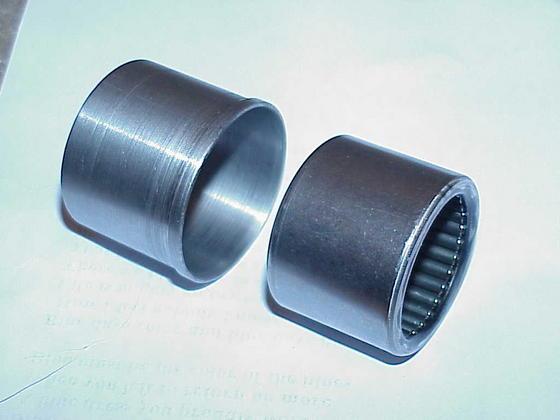

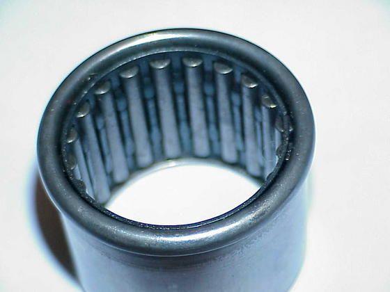

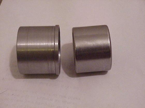

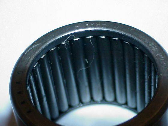

The solution is that the housings are going to have to be bored , sleeved . To test my theory I used an expansion reamer to make the hole round. I pressed the bearing in with shims stock to get the correct clearance . . Installed it on the truck... Zero slop at the wheel... .
I am having some carbide cutters made now for the boring the housings. I am waiting for quotes on making the tubing for the sleevs... It is going to take . 040 to clean up the bores. I contacted several bearing manufacturers to get quotes for making over sized bearings. . The quotes were off the chart ! So sleeving is our only option. I used shim stock for the experiment. But that will NOT work for long term use. IT WOULD BE DANGEROUS to do so.
