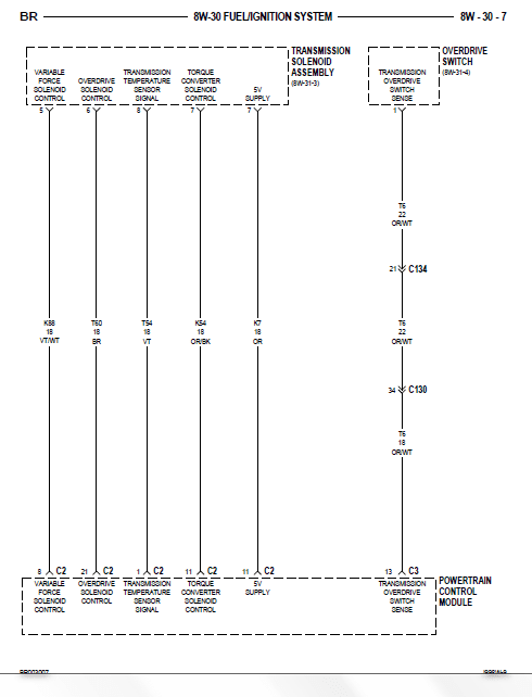

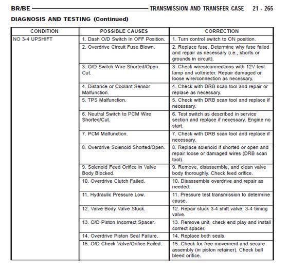

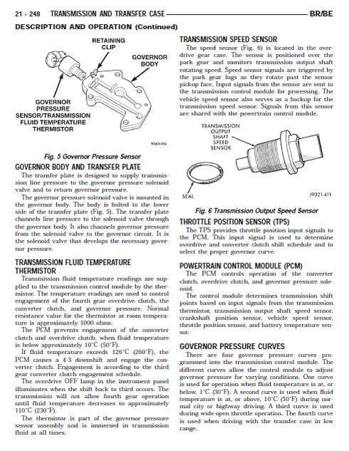

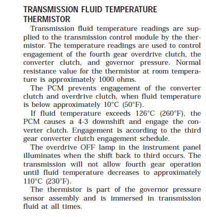

Here is one scenario with the thermistor. If you do not have lockup overdrive will be locked out. This is only one scenario.
Dave

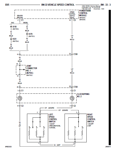

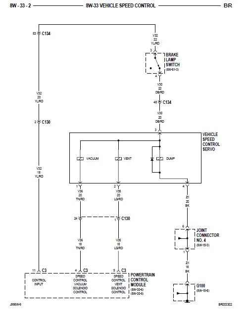

The cruse fixed itself must have been a switch problem from sitting.

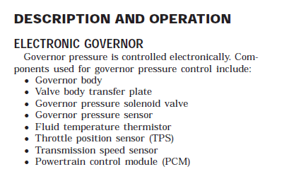

Now I have my scan tool and get P0743 out of it. It is strange (to me) that when I clear the code there is no over drive but cycle the switch and the code reapperes along with overdrive working. The connector on the transmission seems to be ok. What function does the speed sensor play in this?? I thought that it might be the reason for the cruse not working but it has returned without lock up.
Need to get out the ohm meter and check the solonids
