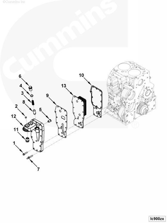

This is from my '06 but yours should be the same.
Number 4 is the pressure regulator, and Number 9 is the pressure relief.
You should be able to get the regulator out and see if it is scored, has something stuck in it, etc. without getting in too deep. Spring could be broken as well.
I can give you a part number but I want either your truck or engine serial number first.
More engine guys will jump in, I'm sure.

I had one similiar. There was no visible signs of wear or scoring replacing the complete housing was required to repair it

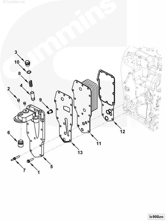

Ok, here we go.
The graphic for your truck is a bit different than mine so here it is... .
#4 3929457 O-RING $3. 44
#3 3925009 SPRING $2. 89
#8 3947287 PLUNGER, PRESSURE REGULATOR $7. 03
#5 3936365 VALVE, PRESSURE RELIEF $7. 51
#9 3864458 GASKET, FILTER HEAD $12. 65
#10 4895742 GASKET, OIL COOLER $18. 43
#12 3965152 HEAD, LUBE OIL FILTER $57. 74 (INCLUDES #11 OIL FILTER NIPPLE)
I can not tell if Item # 12 would come with the valves all in it or not, I can't see that level of detail.
You may want to ask before ordering, we dealers are not privy to all the info like the distributors are.
My Cummins distributor stocks the spring and relief plunger which indicates that they must have a little trouble with them, or it is the first thing that gets changed with an oil pressure complaint.
If your local Cummins dealer / distributor does not have these and you want them in a hurry tell them you want overnight delivery from the factory. The freight charges should be 12% of the price of the part. For example a normal size part that costs $100. 00 will have an air freight charge of $12. 00 on it. Freight is pretty fair from Cummins.

When I ordered mine it was a stripped unit will have to order everything seperate.
