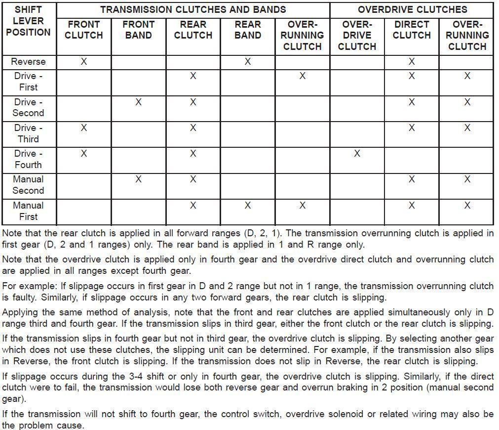

This chart might help:
Adjust your rear band. i suggest removing the valve body to be sure it gets adjusted correctly. the band should be sloppy loose, almost to a point you think it’s too loose. Spec is torque it to 72 inch pounds, then back off 2.5-3 turns. I have built several transmissions, and i always back mine off more like 3.5 turns. If the band is too tight, it drags on the reverse drum that it goes around, and wears the band as well as the drum. It happened in my personal truck, which is an 04.5. I put in a new drum and rear band and backed off until sloppy loose. works great no matter the weight i’m pushing backwards. Over 450 horsepower and 35 inch tires pushing 15k+ pounds and it has done great.
