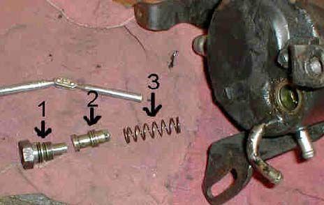

No power steering on our 95 3500. We replaced the pump with a napa rebuilt. nothing. took off vp it is ok we have vaccume. no broken shaft. replaced gear box,nothing. which way does the spring and plunger go in? We tryed both ways. suppose we got a bad rebuilt pump? Im getting tired of taking this thing off.

The o ring is in the groove closest to the hex nut. I had the vp and ps off as a unit. everything turns. When I turn the wheel lock to lock with the engine off or on it pushes to oil out the fill tube below the stick reading. it just seems like the ps pump is not making pressure. im about ready to get another ps pump
