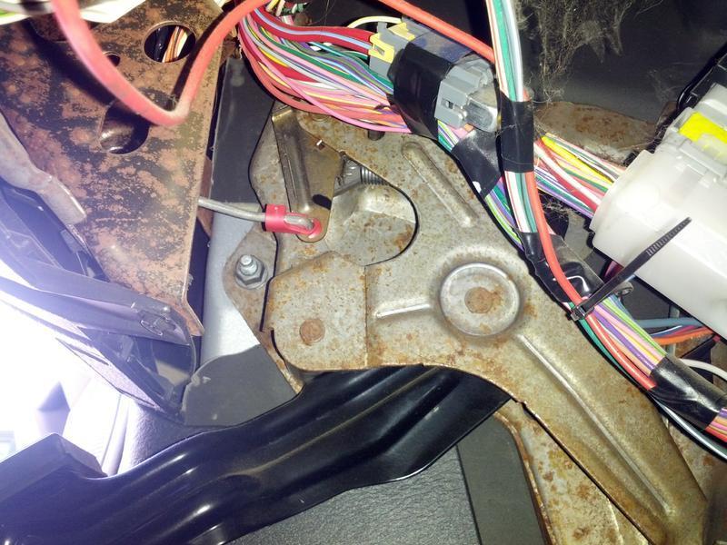

I fixed a co-workers tail light issues on her '06. It was similarly weird and presented itself when she plugged in her 5th wheel. Found a thread here that said the wiring loom that runs next to the parking brake rubs and eventually causes a short to the tail lights. Looked down there and found the exposed wiring. I taped it up, moved it away from the brake and everything works as new.

I fixed a co-workers tail light issues on her '06. It was similarly weird and presented itself when she plugged in her 5th wheel. Found a thread here that said the wiring loom that runs next to the parking brake rubs and eventually causes a short to the tail lights. Looked down there and found the exposed wiring. I taped it up, moved it away from the brake and everything works as new. I don't know if it helps, but it's another easy place to look.

Scooter was the wiring rubbed on the parking brake cable or was it something in the cab?
Sorry I haven't responded sooner.
The wiring was rubbing the metal of the parking brake foot pedal in the cab... The wiring runs next to it. Over time it just rubbed through the wiring. Poke around these wires:

Just to follow up, I think my memory is telling me that it wasn't actually rubbing on the brake itself, just some of that underdash bracketry shown in the pic. Regardless, glad to hear it was resolved.
