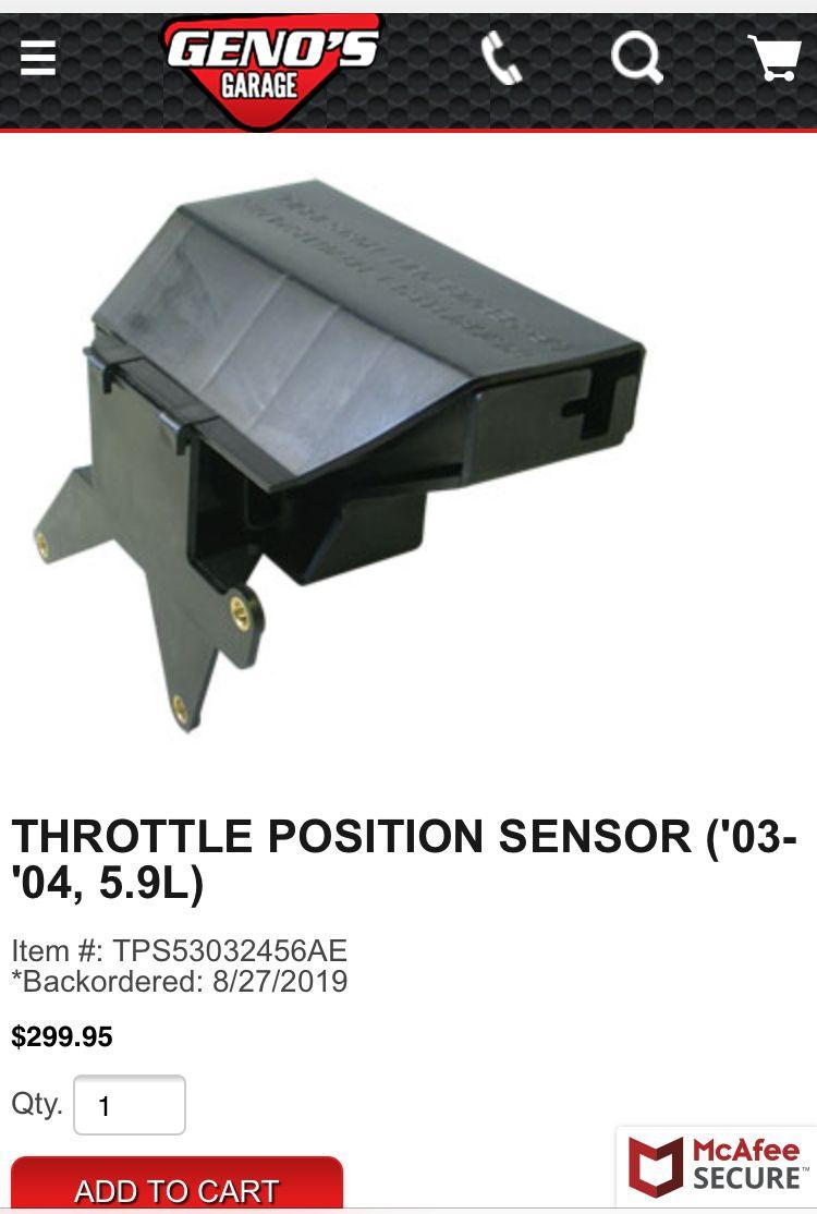

So I’m down with P2121 and a bucking throttle, and I’m searching for a new TPS/ APPS. They seem to be impossible to get, Genos and Rock Auto has em on backorder. Anyone have another source?
TIA!

John, I tried for 30 minutes to call Summit to verify stock on the APPS, and they were busy on 5 attempts. Gotta admit, I haven’t had that problem in quite a while!

I went with the TPS from Autozone (Wells) that is contactless and should last, also with Lifetime Warranty.
I left the TIMBO in my boonie box.
Works as disered, installation was straight forward, after the relearn of the ECM everything was fine, all Codes are gone.
