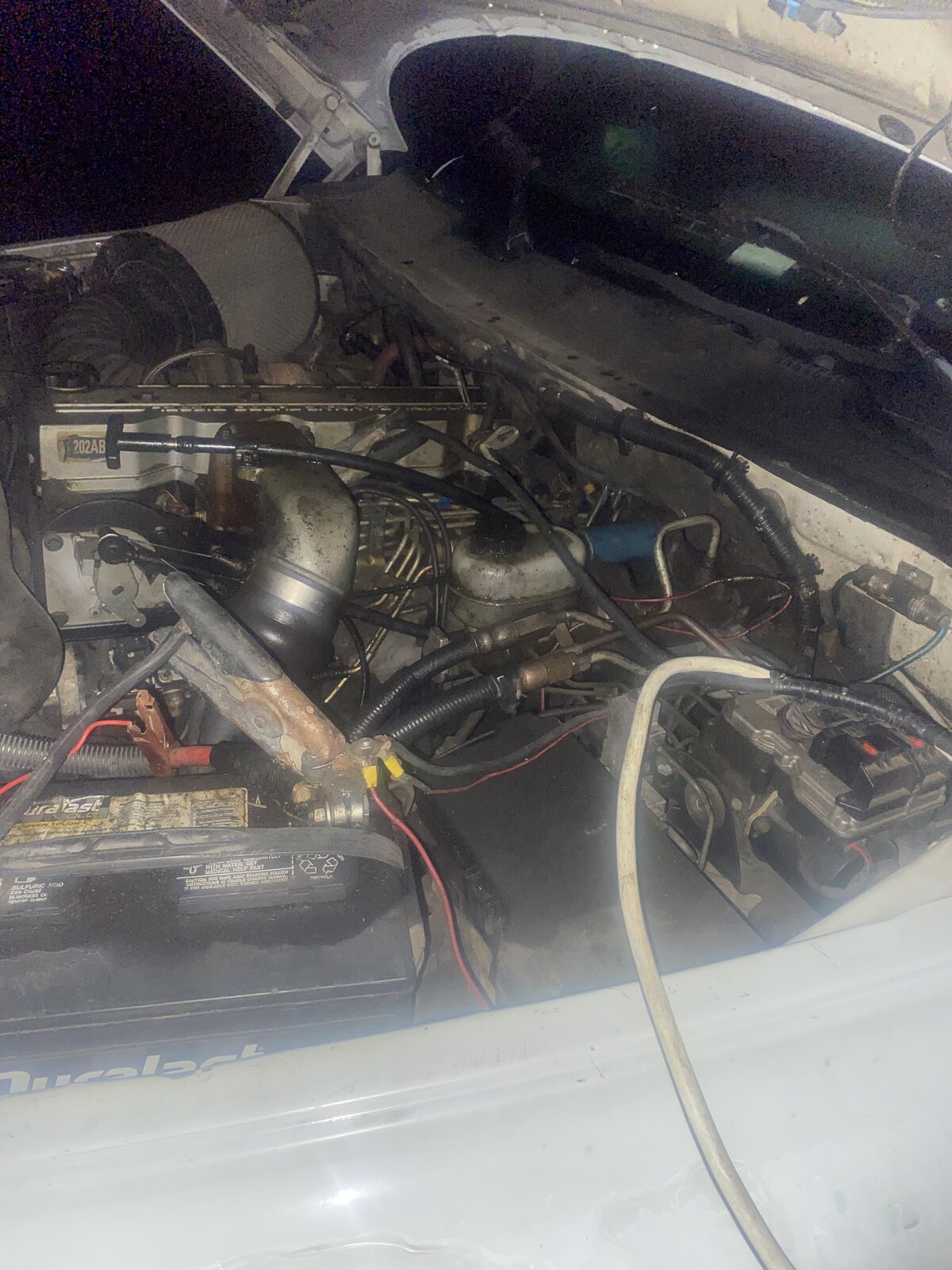

Desperate to figure this out and avoid the mechanic
Losing prime
March of 98 build date 24 valve no wait to start and no preheat on the intake heater post heat cycles are working . Time for a new ecm ??

I think what @Ozymandias was eluding to was that for the vast majority of engine starts, the grid heaters are not needed, especially for post cycling. I have modified mine to be activated by me with the use of a momentary switch.
Regardless, the real concern is your wait-to-start light is not illuminating when the ignition switch is turned on. That could be an ECM issue. Have you checked for any stored codes?

need to find a scanner and check post heat cycle works pre heat doesn’t
