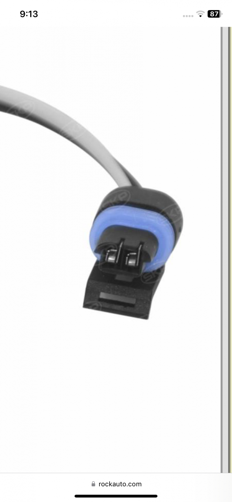

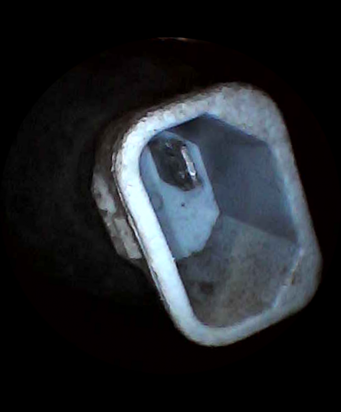

I bought the cluster GAmes told me about. It works but the temp gauge doesn’t work and I found out the wire to the sensor is cut or chewed. I ordered a new wire connector but it appears to be different than the sensor connection. Anyone have an idea? The sensors has one spade and the new connector has two and what tools like a different shape.

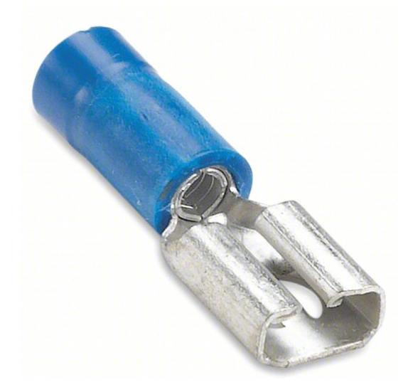

Thanks to Games and the community for the help. The cluster Is fully functional except for the 4WD light burned out. The temp gauge just needed the spade connector and is working. The fuel gauge reads empty but I guess the sending units are known as a weak link? I figure I can track my fuel use on the trip odometer.
