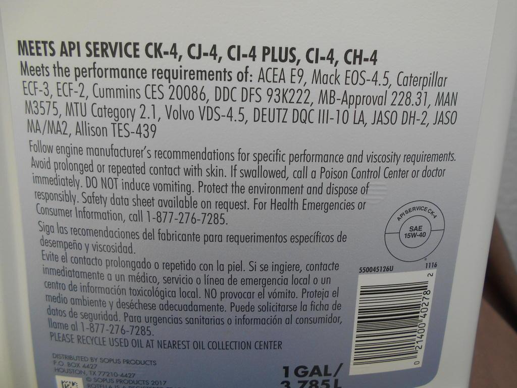

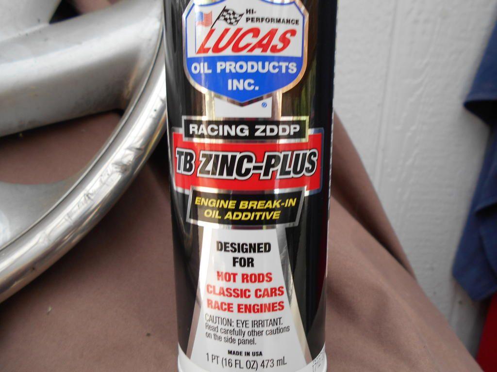

Since my last oil change, I've notice more valve train noise, since I have used Delo 400 sde. Its getting close to changing the oil again ,and I'm thinking of going to rotella t4 15W40, instead of the Delo 400 CK-4/SN.I was reading that since the DELO 400 is labeled SAE SERVICE CK-4 /SN, that it my have less of the good stuff for are older engines,since it has SN in the SAE SERVICE, intended more for the newer vehicle emission engines ,than the rotella t4 15W40, which is labeled SAE SERVICE CK-4.If I go with rotella t4 15w40. Should I find a additive with ZDDP to use with the rotella? I have a bottle of Lucas TB ZINC-PLUS, that I use on my older vehicle,with flat tappet cams.

I personally think you are overthinking this. Delo has been an exceptional oil. The CK4/SN scare was brought on by Ford because in their limited testing deemed the lower phos numbers "may" cause increased wear. Keep in mind their engine design is nothing like the ISB. Cummins says as long as an oil meets CES (Cummins Engineering Standards) 20086 you have nothing to worry about. Here is the approved registry from Cummins that requires extensive ISB and ISM specific testing - some of which were NOT required for the CES20081 (CJ4) approval. IMO, the CK4 is a superior oil over the CJ4 spec.

Hey , JR maybe I am over thinking it:D. I have all ways used Delo 400 in my 97 dodge and have been very happy with it. It just seems this last oil change,the engine sounded different( valve train noise).The truck only has 117,626 miles on it, and my dad had the valves adjusted 90,000 miles when he had it.So I assume now most of the new oil, not synthetic is the same Delo, rotella,Mobil Delvac ,etc.What is your opinion about using a additive to boost the ZDDP, or is it a waist of money. Thanks Dave

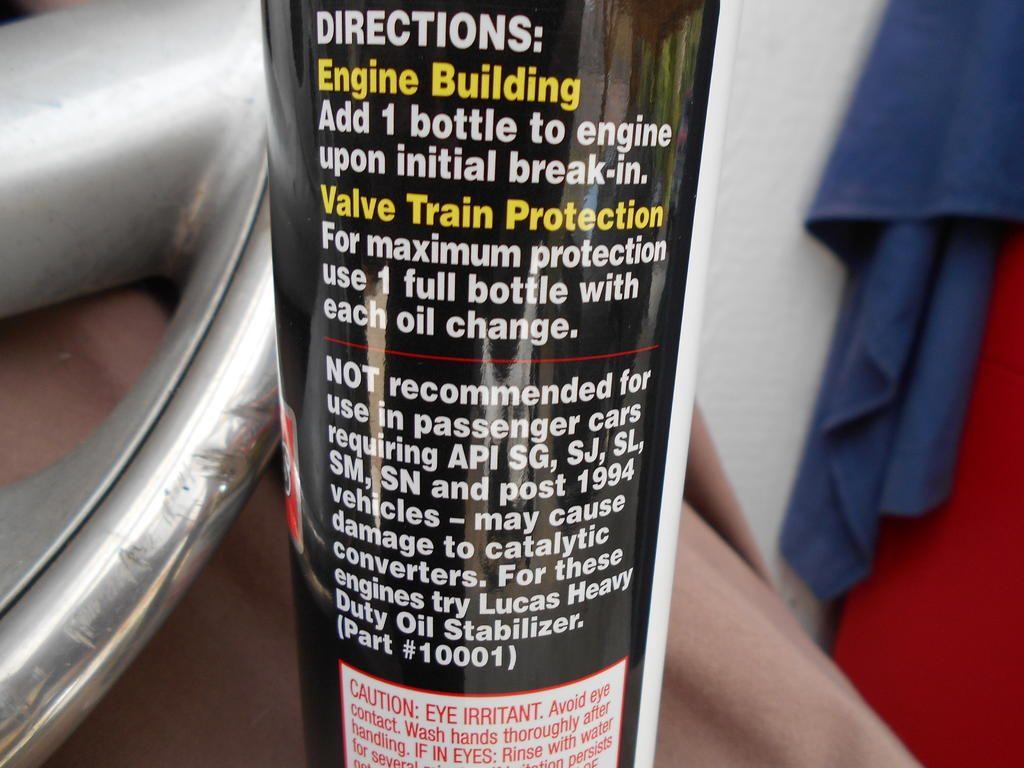

I run the Lucas TB ZINC-PLUS as I put in a aftermarket camshaft with 110# valve springs and HD pushrods. Further looking at a bunch of torn up Cummins camshafts at the engine rebuild shop... I used 2 bottles per the directions on 3 gal of oil for break in, but, UOA indicated the zinc levels were extreme high. So it does as advertised, but, 1 bottle is enough after break in.
Other oils like Amsoil Marine is worth a consideration vs. the added cost of the Lucas to modern EPA oil.

Moparguy, your comparing CK4 (Delo and Rotella) to CJ4 (Travellers) so it isn't exactly a direct comparison. I don't know if or when Travellers will make the jump to CK4 but I have to imagine the reason they haven't yet is because the CK4 test criteria is significantly harder to get. There are new ISB/ISM specific tests that were added to the CK4 test
I'd run a CK4 oil over a CJ4 regardless of brand.

On the flip side, any oil that carries the CES20081 or (preferably) CES20086 is APPROVED
by Cummins.
