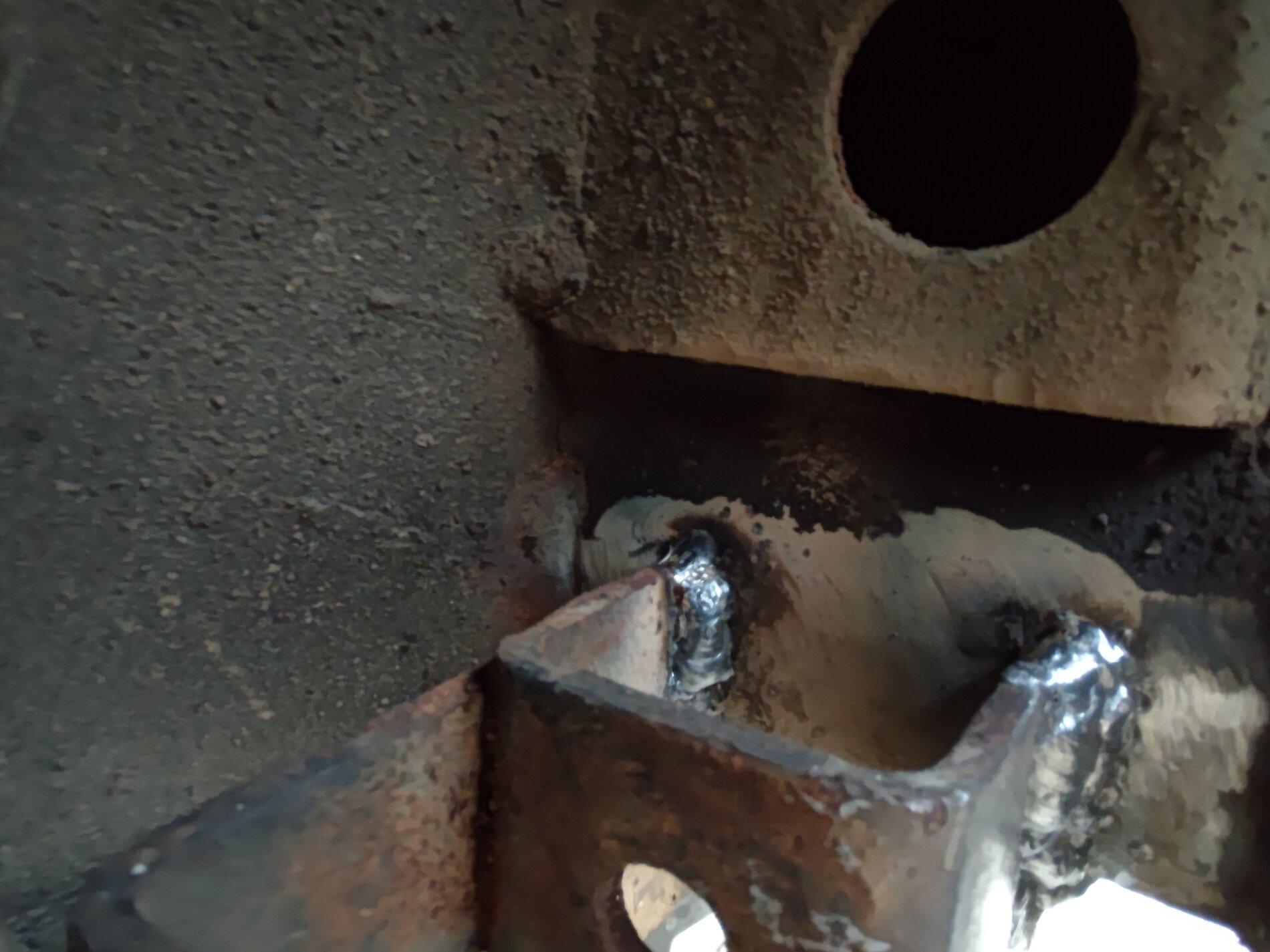

While the weld is far from ideal the issue likely has more to do with what looks like a shock spacer that in there, I have seen this before and if that spacer is too long the shock will bottom out before the bump stop and puts a tremendous amount of stress into the mount. As we have been talking about get the correct length shocks and ditch the spacer!
