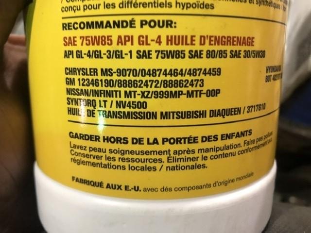

Since I can’t reply to my own thread I did a Little more research and decided to go with the oil quad 4x4 sells he knows his stuff and I trust what he says and the products he sells . I dumped the royal purple in the front diff and went with the 75 85 gl4 synthetic oil it specifically covers the dodge part number and gm part number and lists both right on the bottle I guess I can’t do pictures anymore either

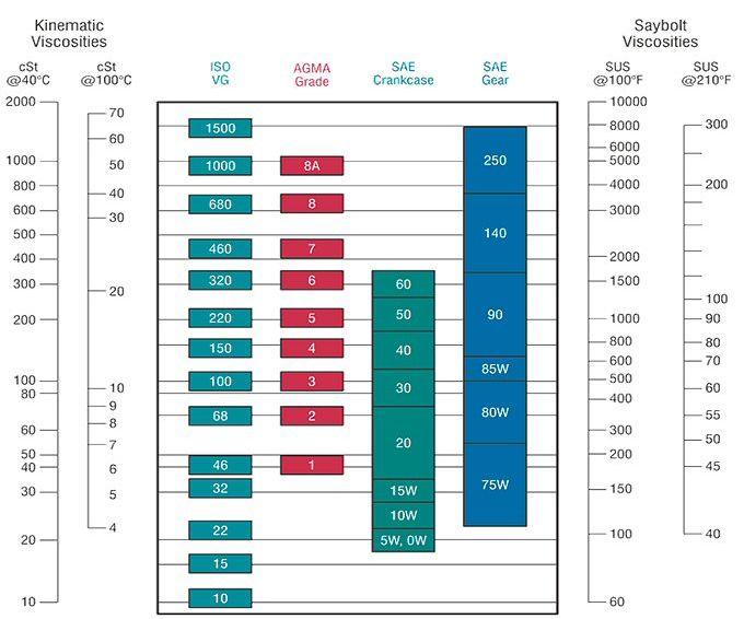

I have the NV5600 and I understand that the NV4500 calls for 75W-90 GL-4. Redline 70W80 works and is a great match for the NV5600. Here is a good chart on viscosity.

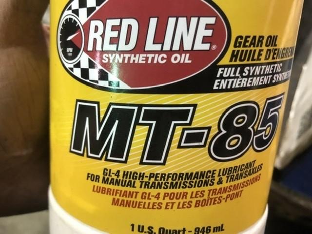

I am running the red line synthetic oil hopefully I can reply this time.
