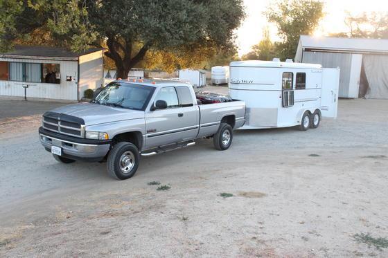

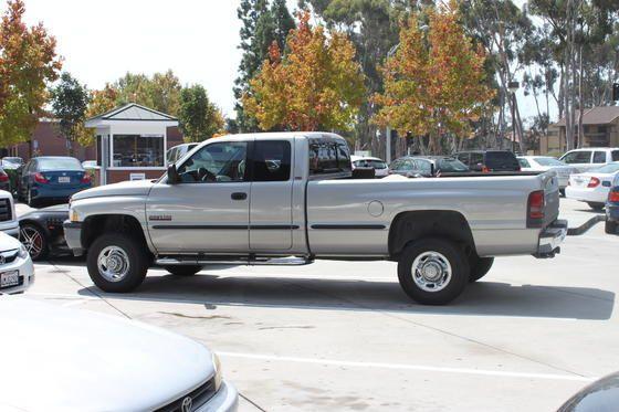

The information that I obtain on this site has been a constant souce of reinforcement. Recent photos of the vehicle in service:
1) Truck packing up for San Diego trip. 2) Truck in La Jolla, California. Go Big Truck!
