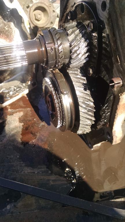

i am pulling the trans tomorrow see the extent of the damage maybe it wont be to bad . this trans has 245000 miles and has lost fifth gear 3 times in its life . i only use the recommended oil which now i hear is no longer available i also run a trans filter and change the oil annually

Here the damage

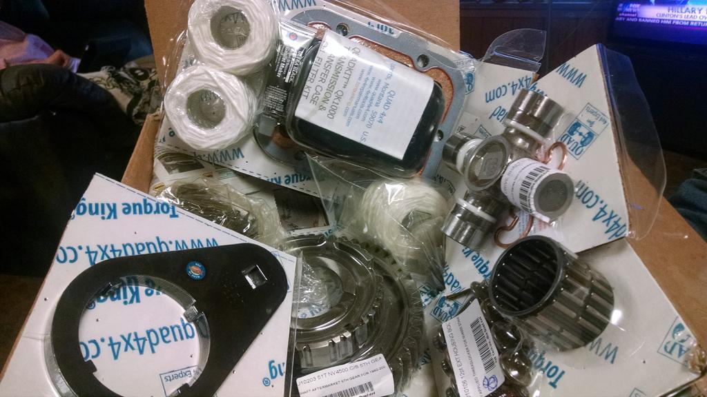

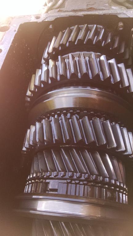

Well since the gears in the main case looked so good and the trans was working good I ordered new gears from quad 4x4.
and a fifth gear repair retainer and I'm going to put it together and run it
