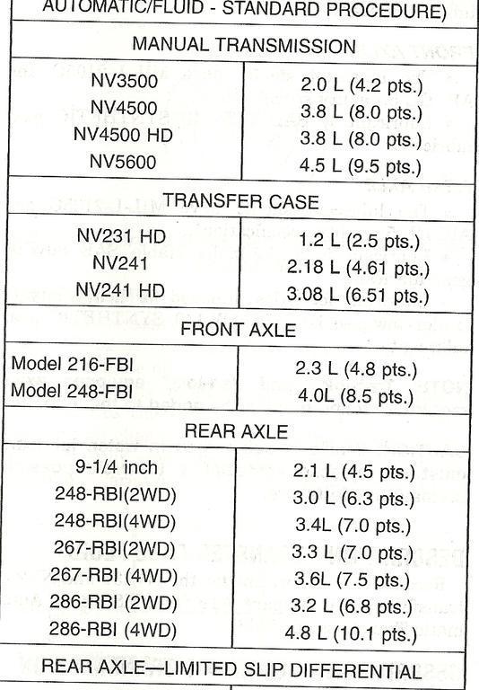

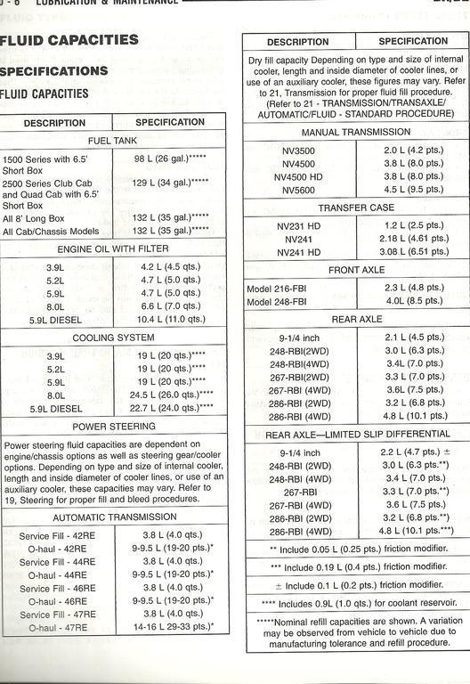

Here is a copy of the Fluid Capacity page from my Service Manual.
Nick

That might be okay because it only takes 4 qts to the fill plug, so adding another qt makes sense if the book calls for 9.5 pints. I am thinking that NV used that fill quantity with the transmission sitting level on a bench. In the truck, with the angle it is mounted at it takes less. I change mine every 36k so that means I have changed it 7 times and I can only get 1 gallon in. Maybe I will add an extra pint of so the next time I change it.
Nick
