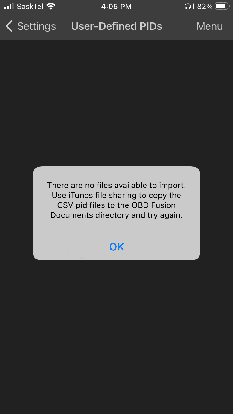

My Veepeak BLE showed up yesterday. I installed OBD Fusion app on my Iphone. I found the link for the Torque app CSV file that others have used on their Cummins trucks. I get this message. I can smell the smoke as it exits my ears. Technology can be fun. Probably something easy to do but I’m not smart enough to figure it out. Uncle Google isn’t helping today. Thanks

I figured out how to load a CSV file onto the OBD fusion app. Install ITunes on your computer, upadate your phone, then file sharing becomes available. Easily done after that. It’s very cold here right now. Not sure I’ll be driving the truck for a while. I’ll update once I get my dashboards set up and get using them.
