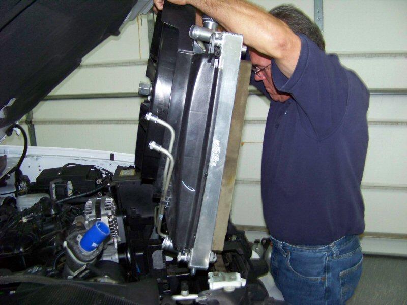

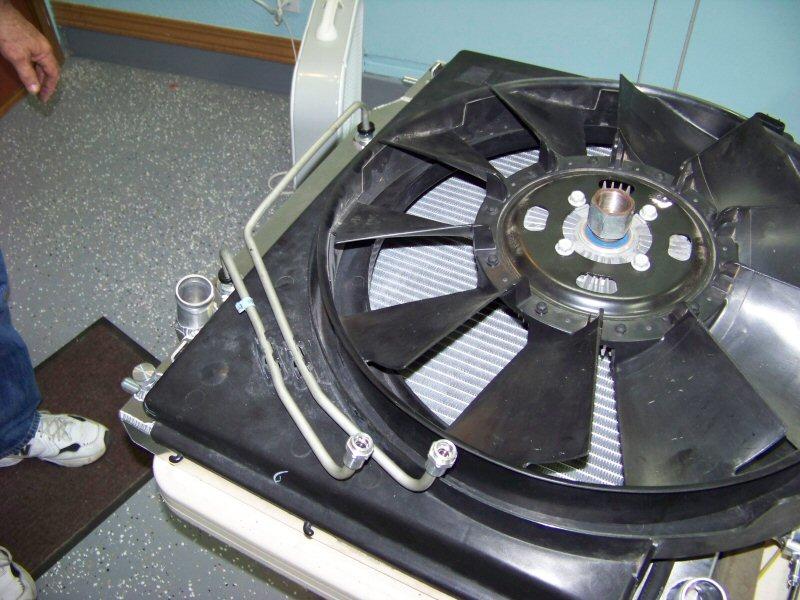

First prototype radiator with the EV fan clutch for a Trailblazer SS.
The Trailblazer SS was equipped with a electronic cooling fan like the newer the Dodge/RAM Cummins (Except the last years GM went cheap and back to obsolete thermal spring clutches and GM went Bankrupt anyway. GM delayed the needed modern electronic fan clutch on the Duramax as well as it was promised for 2008 model years.) Anyway I was able to manually lock up the Trailblazer fan clutch in via a "tune" and measure it at specific RPM's.

OEM Fan Diameter 21” (Wow!)
9.75” of the center wasted due to clutch and fan center blockage.
No free air space between blades. (High suction ability for restrictive radiator stacks.)
18.75” shroud Diameter – rest used for double ridge air seal and noise control I guess.
13.5” from bottom to upper restriction on shroud. Upper shroud restriction is 3” from fan. This is from fan center being too high for radiator location. Top of fan circle is over the top of the stack.
