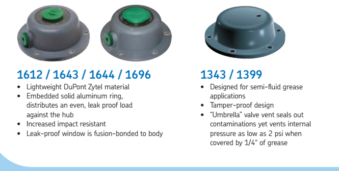

Some fleets have gone to a Mobil Synthetic grease (stuff is bright red) in trailer axles. Cuts down on wheel seal leaks and overfilling issues. That set up uses a solid hubcap. Stuff liquefies when it heats up and solidifies when it cools back down. Expensive but works really well.
Synthetic is almost a necessity now that 95% of the big stuff has outboard drums and Budd style wheels. The old spoke wheels and inboard drum Budds required removal of the hub so the wheel seal and gear oil got changed by default. The bearings were also inspected at that time. Now with outboard drums the bearings and seals don't get touched unless there is a leak or some other issue.
Hub cover on the right is designed for the semi-solid grease......

I was told by my NAPA parts guy in town the same thing stay away from Straight Dino Oil because of leaks, also the caps that Dexter had originally I didn't care for (pictured below) they are just plastic that didn't weather very well and with the chemicals that are on some roads during the winter they became brittle. The same NAPA parts guy looked around and found some cast aluminum or at least it looks like aluminum. They are press fit but closely resemble the old Stemco hub seal that are on BIG RIGS of my era only without the bolt on flange like the big rigs had. Same red fill plug and all with the sight glass not plastic that I can see the oil level with just a glance. I used a high temp RTV sealant to seal the press fit and have yet to have a leak. I think that im going to stick with the Delo Syn gear lube on the bearings I was just wondering what if anything is new in the market. Years ago we use to use half & half of Dino gear lube and STP over fill just a tad and quickly put the plug back in when your running down the hwy the oil is slung out to the edge of the hub and bearing anyway.
Mike the red grease was used in Booster axles on concrete mixers for a long time, don't know if or what they use now. The grease was put in much the same as hand greasing a bearing (only with a pressure packer) then installed with a non viewable cap like the one on the right in your picture. They were check periodically if they ran dry and seized it was disastrous
