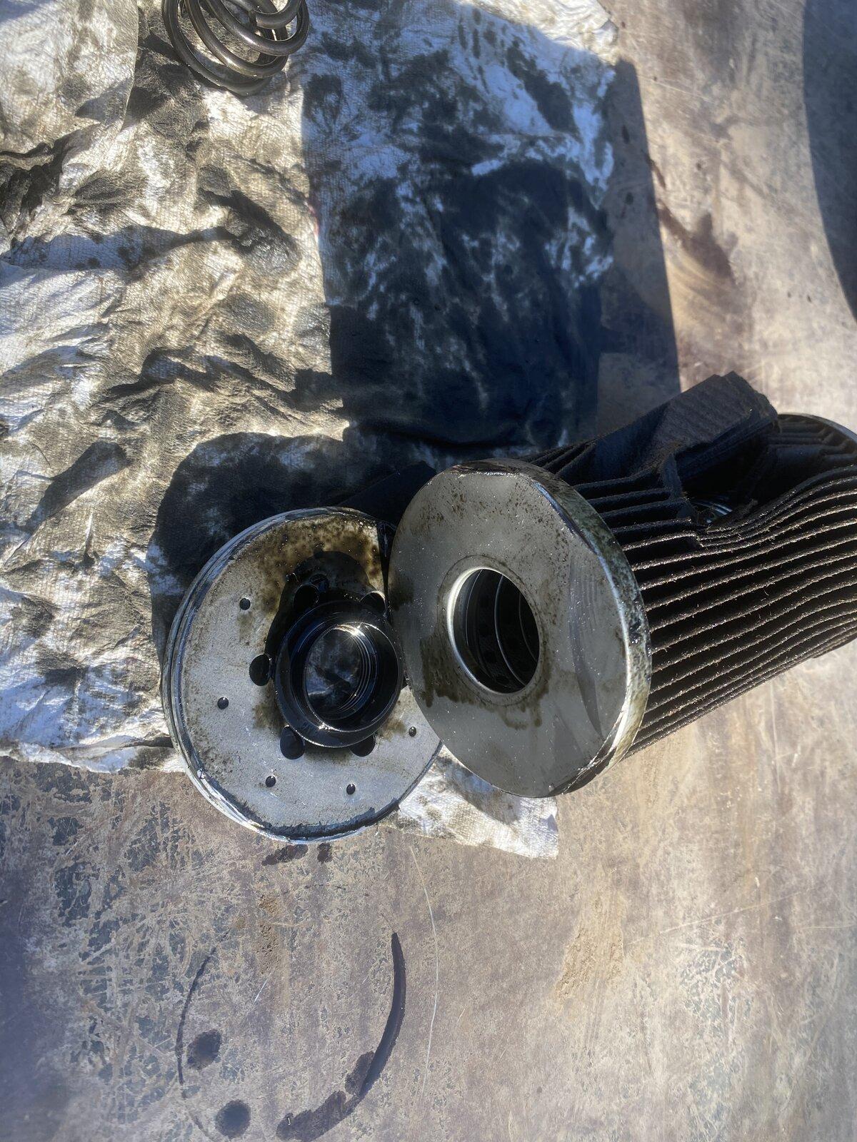

Cut a wix apart and I wasn’t impressed with it

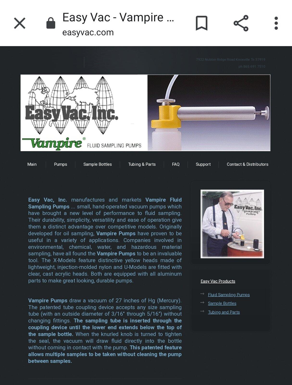

Check out Easy Vac they make that vampire sample pump so you can pull it from the top of you like. Or just run it and if it bothers you change it for piece of mind.
