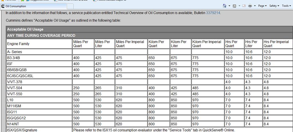

the following chart is from Cummins and defines what Cummins calls excessive oil usage.
With these numbers you run actually a two stroke, 675km/L is way beyond acceptable today.
They really want to keep the warranty claims down that way.
