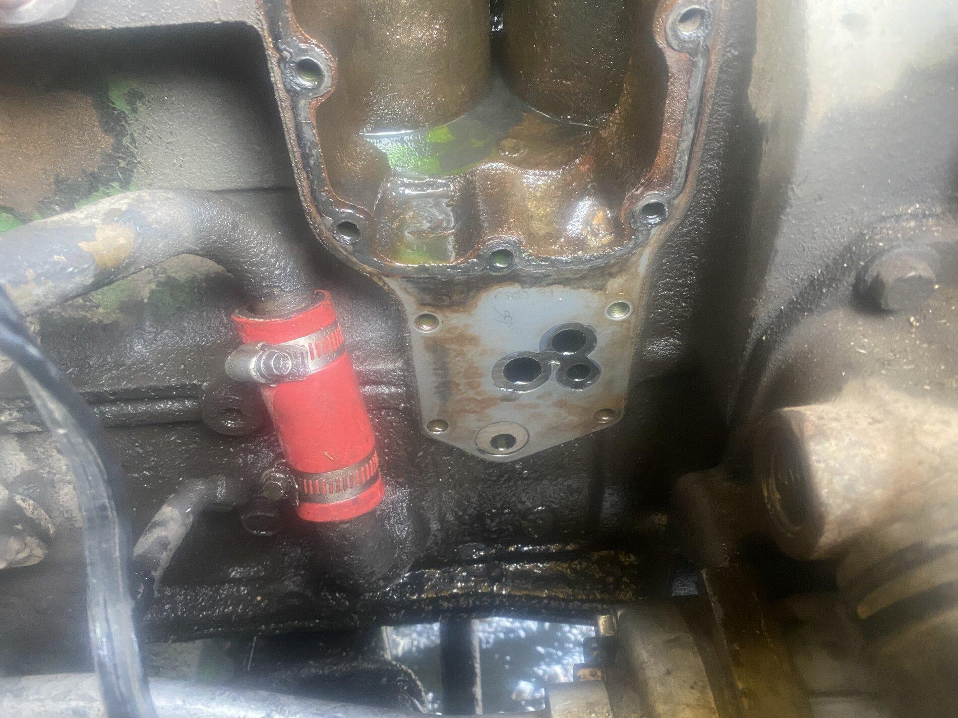

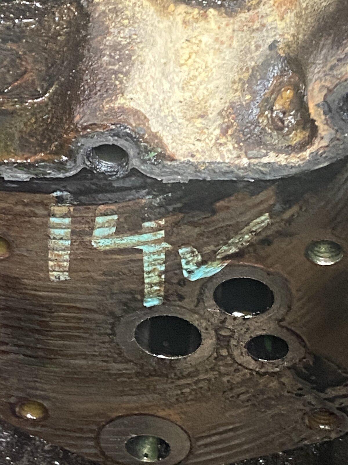

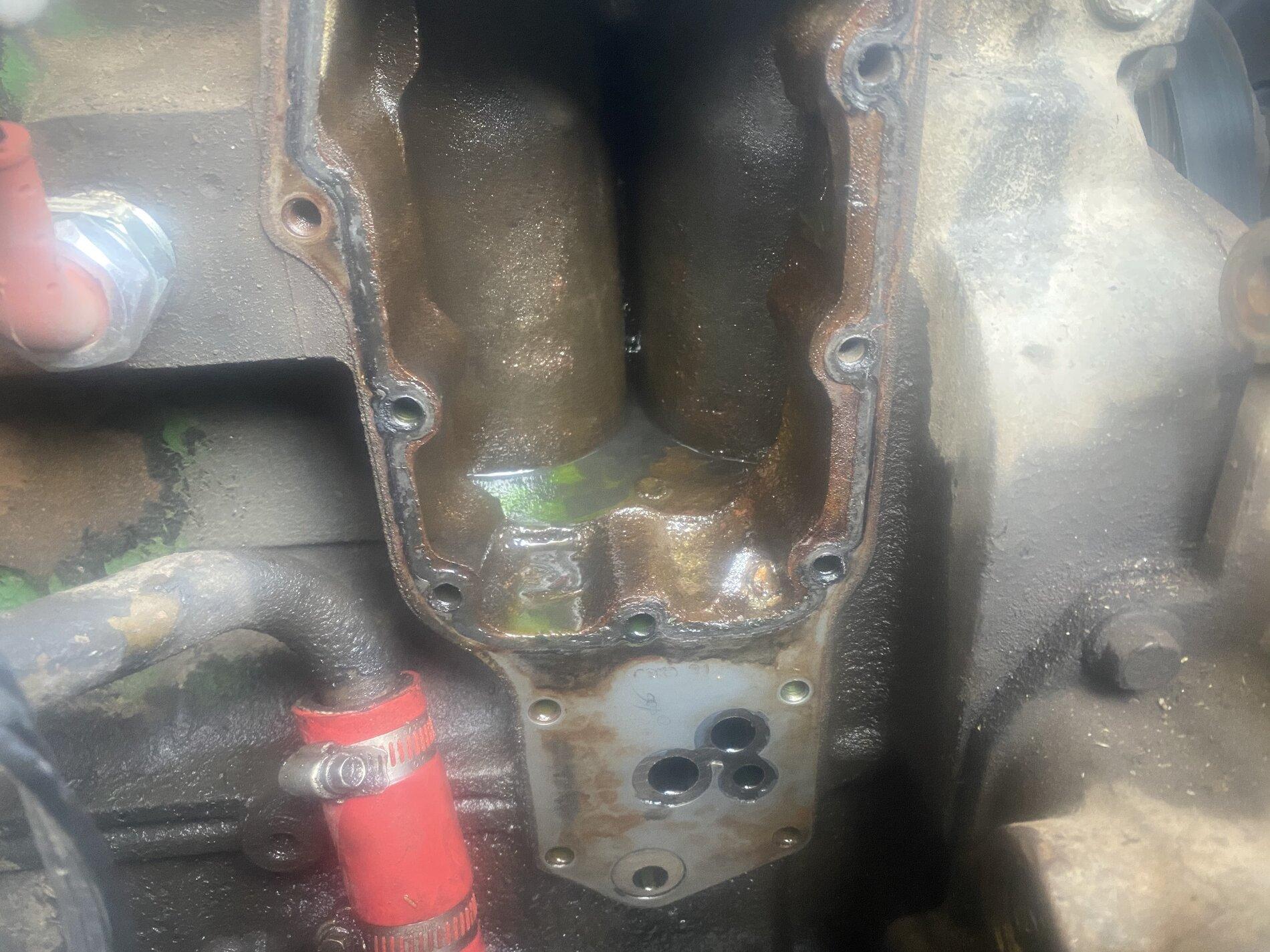

Are you still running your broken welded block? If so, that might be the source of the water/oil mix and not the oil cooler.
There is a large horizontal oil galley and 6 vertical oil galleries on that side of the block. If the crack migrated inward it could mix. I assume your cracked block is on the driver side?
Never heard of one cracking on the left. There’s already a big hole on the left covered by the tappet cover.
