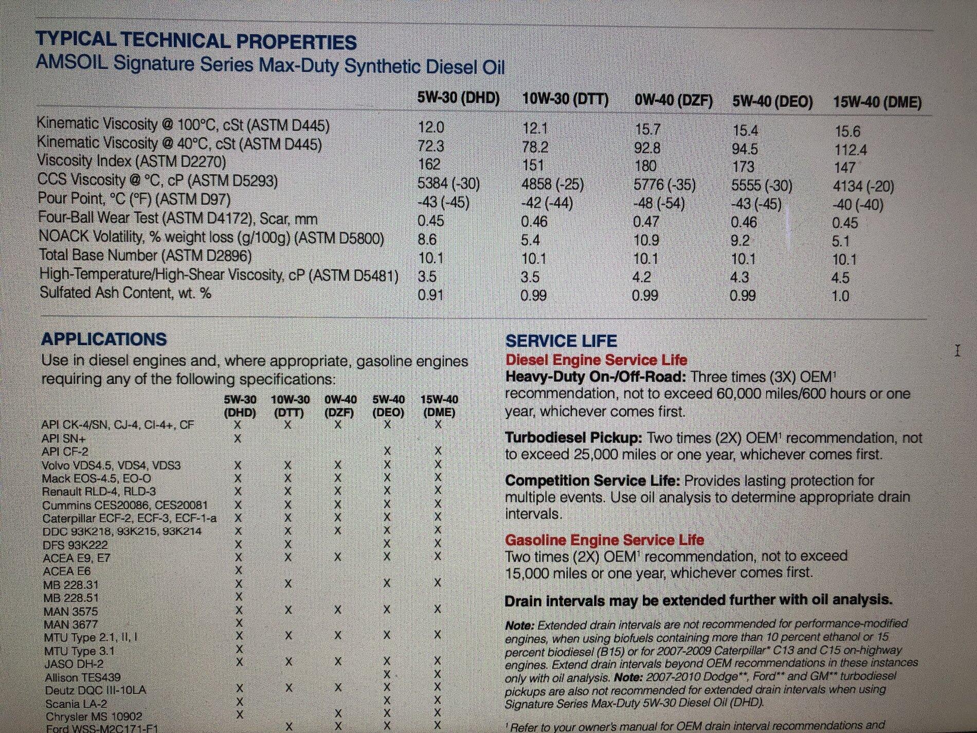

Personally will only run 15-40. AMZ/OIL for example the pour point is only 3 degrees different between the 5-40 and 15-40.
So is it really worth it??????
15-40 DME -40
5-40 DEO -43
15-40 DME -40
5-40 DEO -43

Someone brighter than me can decipher this info. I think the 15-40 is better?
The 5-40 is a bit more $.
They both look good to me. The 5-40 and 15-40. With stock non deleted trucks, the sulfated ash looks better on the 5-40 to me. Also the lighter 5-40 should flow faster at start up with the same protection at operating temperature. Just theory. I’ve used 15-40 for 40 years.

Just looking at the above posted photo, other manufacturer specs are sometimes harder to find, the big things I look for in a diesel oil are Viscosity at 100°C, NOACK Volatility, and High Temp/High Sheer Viscosity. Other stuff is also important, but these 3 are big ones for me.
The 0w-40 has the highest 100°C viscosity, .1 higher than the 15w and .3 higher than the 5w. When I switched from an oil with a 100°C viscosity of 15.0 to one with 15.6 I saw 3-5 more psi at 2,000 rpms and the oil ran 5° cooler at cruise. While towing it held 2-3 psi more and slightly cooler. This was with aftermarket oil temp and pressure on my 05. So I like this number a little higher for heavy towing. Win 0w-40.
The NOACK Volatilty always increases the higher the multiweight spread is, which is why the 15w-40 will burn off 80% less than the 5w-40 and 113% less than the 0w-40. Win 15w-40.
High Temp/High Sheer. Higher is better, especially when you look at how much power these things are making now. 15w-40 win.
So even thou the 0w-40 has a higher 100°C viscosity it's only by .1, so I'll take that minor decrease as it's still a better performing oil under heavy load than the others. I do run the listed Amsoil 15w-40.
Based on the published specs from Rotella the 5w-40 has a higher 100°C viscosity than the 15w-40 by .2, but I cannot find the NOACK Volatility rating or HT/HS on either one. I can't find anything on their 0w-40 for CK, but the CJ oil was quite thin for a 40wt.
