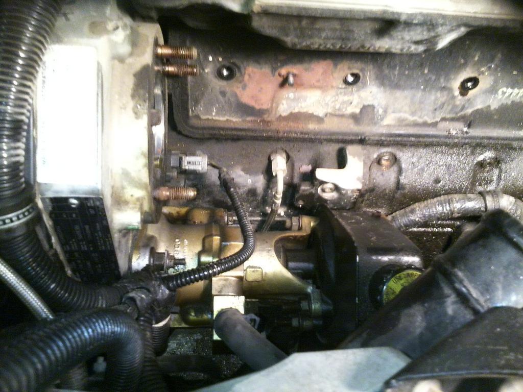

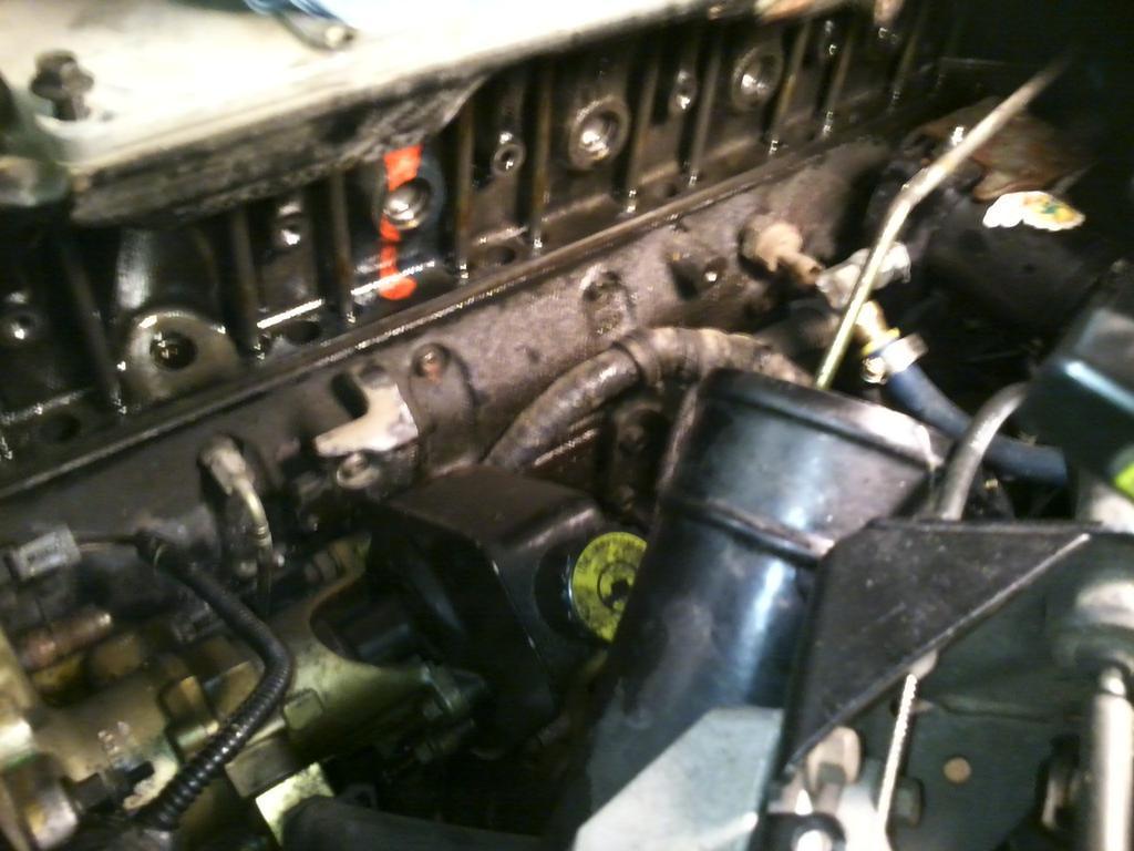

If the tappet cover is leaking it is not to hard to fix, just takes a bit of time. This is a pix of mine. It didn't seem to be a bad leak until I got to this point.
I think it's leaking back there near the lift pump b/c I don't see much oil except back toward the back of the engine.
Gonna get under the hood tonite and find it! Thanks for the tips!
