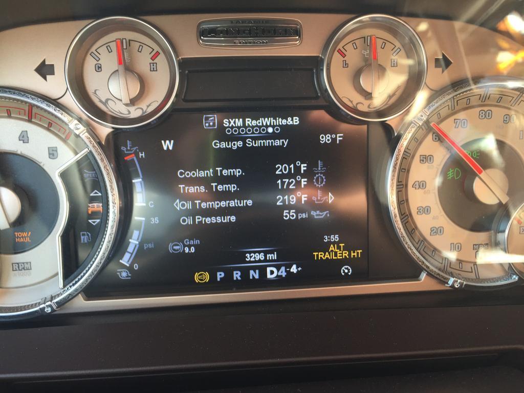

Never thought about it or looked to see what it is. But I want to know what the oil temp should be at operating temp should be. I just put my. Mopar winter front on the truck. And was checking the coolant temp to see if there was any difference. with or without the cover. I just have never paid any attention in the past temp with the cover. Runs about 198. :confused:

I have a 2014 Laramie. I'd kill to have actual numbers for all temp's. It's a guessing game trying to figure out temp's when my gauges just have a white square that I assume being at the bottom is saying cool. In the middle I guess is normal and all the way to the top means She's ah gonna blow. No help from service dept. thinking about good after market ones and install on the dash. Can't put them on the window/door pillars due to grab handle being in the way. Coming home today, over mountain pass, snow storm, 29 degrees, flat stretch of road, oil temp gauge temp was two white square above (I guess) normal mark. Thinking that position was telling me oil temp was above normal which I think was to high for 50 MPH and below freezing air. Can't check other gauges while truck is moving. Has to be in Park to switch over to other gauges. Mountain grade is 6%. Not in 4 wheel, auto transmission/6 speed, in 5th gear. Temp stayed that way until I pulled into my shop. Only made one stop at a red light.

In the summer towing light in the mountains, I saw 212-215 on the fake oil temps.

Actually it doesn't, in terms of oil. There isn't a sender on the engine even capable of telling the ECM the real oil pressure or temp.
It's the same as your 04.5 in terms of oil pressure. There is a 6 psi switch, that's it.

1. Has anyone figured out how are they calculating oil temperature? In other words, what parameters are they watching to calculate temperature? Previous threads guessed it was coolant temps and load.

Engine oil and engine coolant ran almost the same temperature. Think about it, if your heat exchangers are doing their job that's exactly what should be happening.

Yes, I agree with you but we are "best guessing" it. I am wondering if anyone can confirm what other actual measurements and/or data is used to report it?

The temp should be close on the two, but with our small sump the oil temp has the potential to clime 25-50° above the coolant in a long hard pull. I have heard from from those who measure it that it doesn't go much above that.
As far as emissions, the emissions stuff doesn't care about oil temp or pressure so it really doesn't need to know
