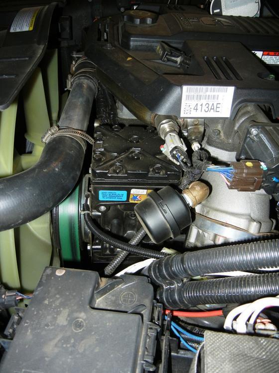

I designed and built a system for my 2011 that uses a York 209SC (mini 209) pump.
Kevin
