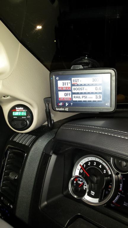

MY ED average MPG is about 9MPG more then My Big Rams Both City/HWY My Big Rams average 11-13MPG City 17-19HWY, ED 21-23MPG City 25-28MPG HWY it about 45% better mileage.
Big Rams 50 gallons @ $2.75 =$137.50
ED 3.0 28 gallons @ $2.75 = $77.00
That's a $60.00 savings Per 50 gallons purchased
My ED will save me about $250.00 Per Month during My busy summer Travels

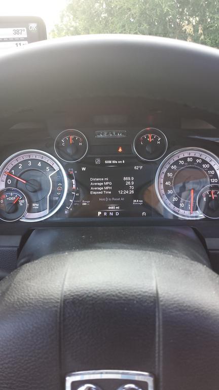

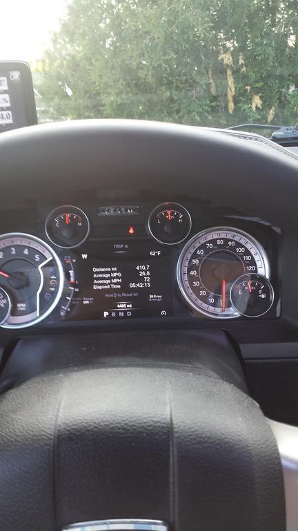

I put 8406 miles on the previous change, the oil life meter was showing 15% at that time.
My last tank was 27.72 mpg hand calculated.
