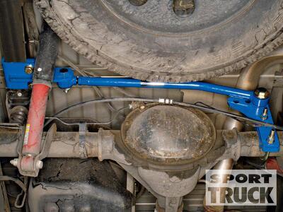

Super Steer SS725 Rear Trac Bar
See April, 2009 TruckTrend (Chris Hemer) article on installation (many pics)
1). Like a rear anti-roll bar it’s a one-hour bolt-on. Truck sits on ground.
Suspension ride/fall not affected.
Axle stays centered.
The work by both bar types is in two planes:
— The RTB is the vertical division side-to-side. No waggle
— The ARB is the horizontal. Keeps level against road plane.
— Imagine a crosshair from truck rear. No more ROTATION on that.
Trailers make that rotation worse.
A trailer is ALWAYS oscillating around the hitch ball. Sway is where it becomes uncontrollable.
Your trailer LOSES leverage against the truck now that the degree, duration & rate of movement is almost eliminated AT THE TRUCK BODY versus suspension/tires.
Is your trailer hitched to the body or the axle?
Stiff springs and over-inflated tires CAUSE wrecks, not just worsen braking and handling.
Trailer leverage can cause a live axle pickup to be MORE LIKELY to lose tire contact partially or entirely. Potholes, camber changes, wet/oily patches. (Buh-Bye). Pickups don’t need this. They’re already the most rollover-prone type.m
On a rough road pickups can start catching under the tires BELOW highway speeds.
Address the problems CORRECTLY and towing plus ordinary driving both benefit. Stay in your lane, upright & centered.
A CTD Corvette?
You’d believe it in a comparison ride.
