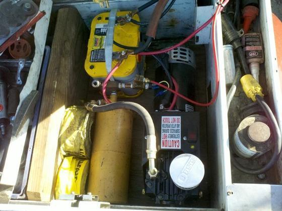

A yellow top is what runs my compressor.
