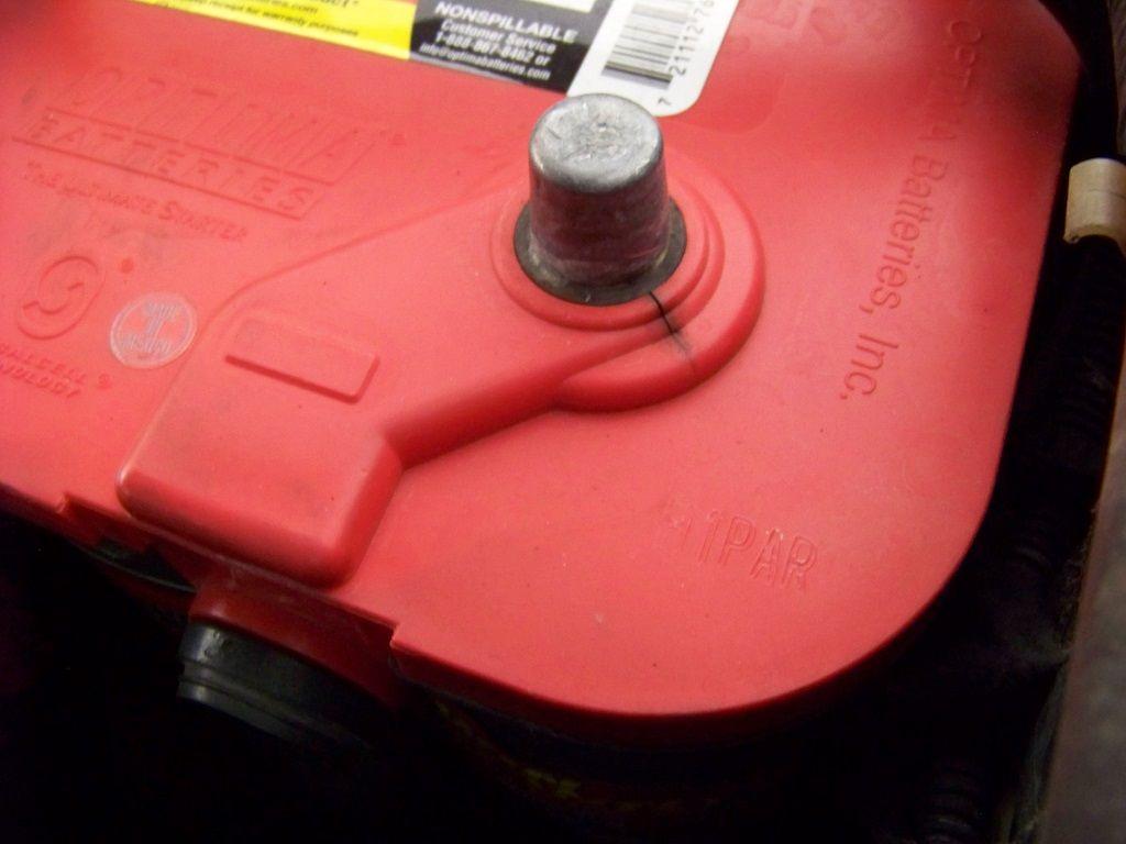

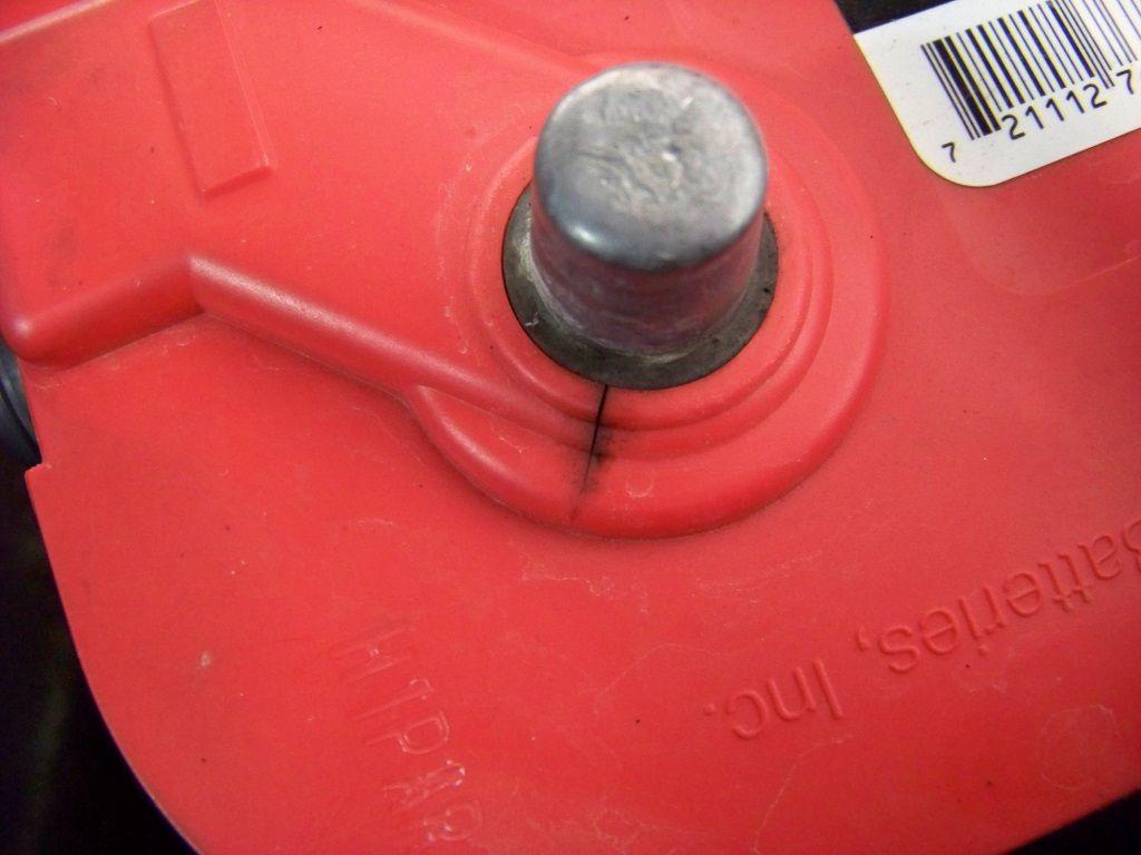

Spillproof doesn't mean leak proof. I have had them leak around the posts from cracking and eat cables and the battery tray. They can't take the heat any better than the flooded batteries. I get max of 3 years out of them and simply gave up on them. Not worth the expense, PIA warranty policies, and short life.

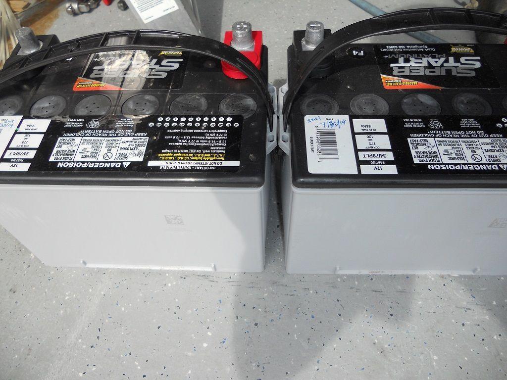

Sears has discontinued the Diehard Platinum lineup........had a couple in my boat that needed warranty and they are no longer available. In a pinch, had to go with the Diehard Gold which are also AGM just not as heavy duty as the rebadged Odysseys.
If you can find the Diehard Platinums still in stock in your area, they're a great battery. Odysseys in a gray case. I lost a couple due to a crappy voltage regulator, Sears honored warranty but I had to downgrade to the Diehard Gold.
