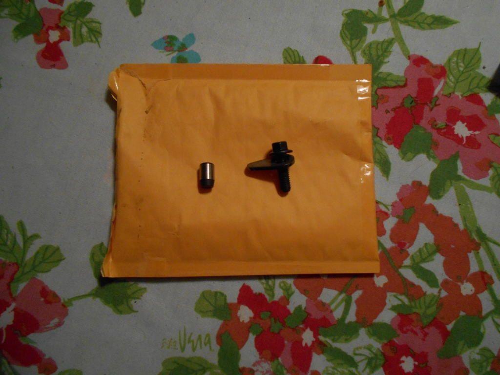

I might have one at home, need to verify. Locates, doesn't hold. I could mail it to you no charge from SC tomorrow if I still have it.

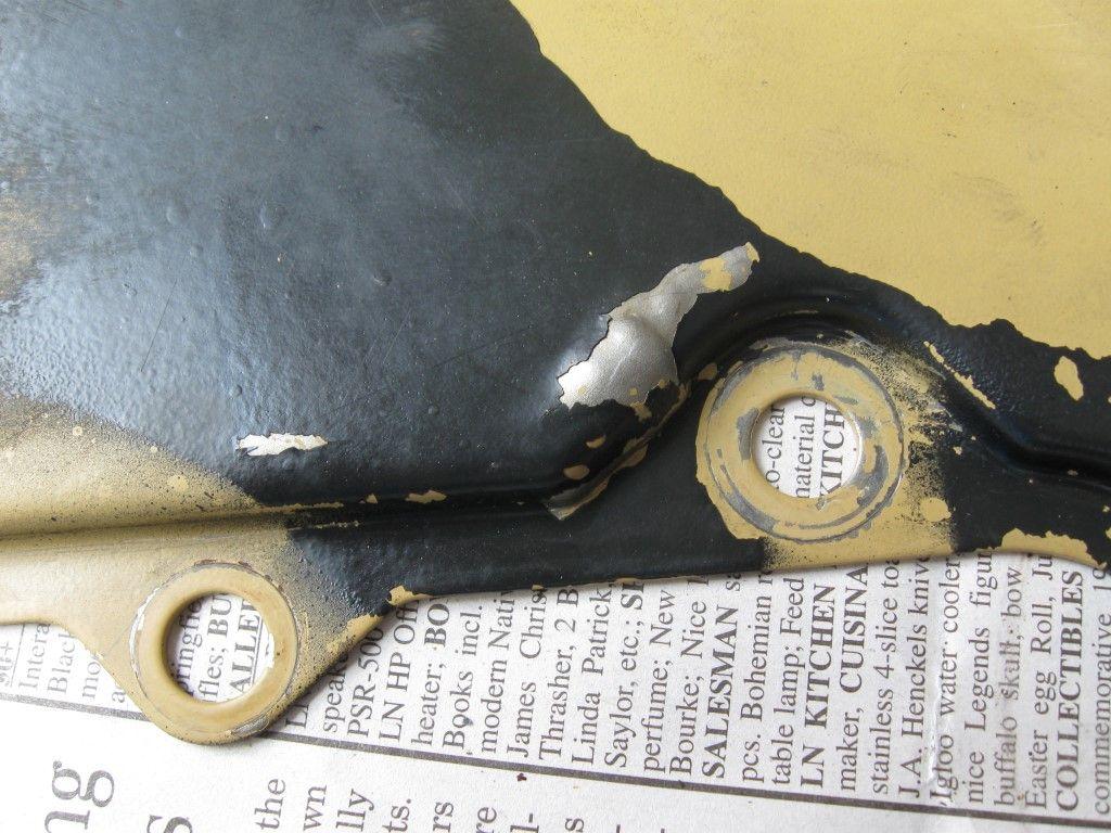

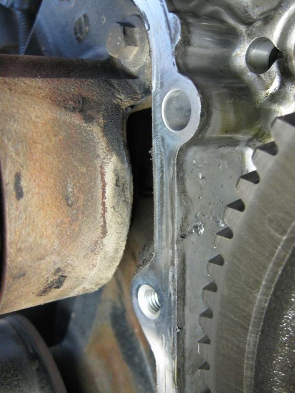

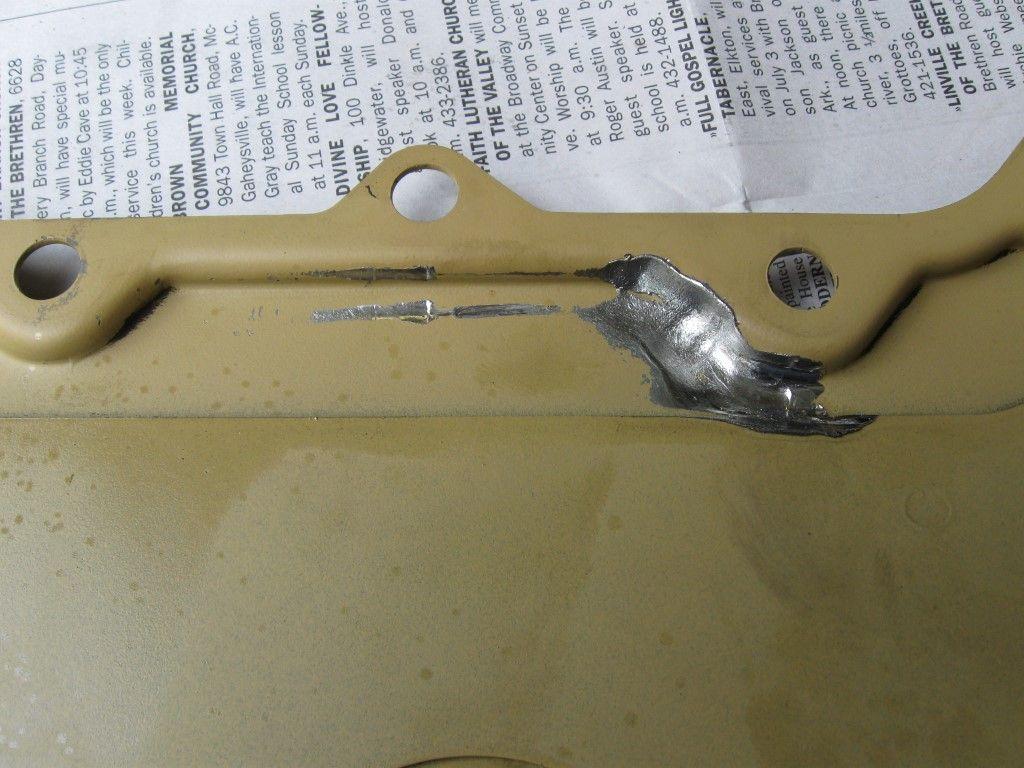

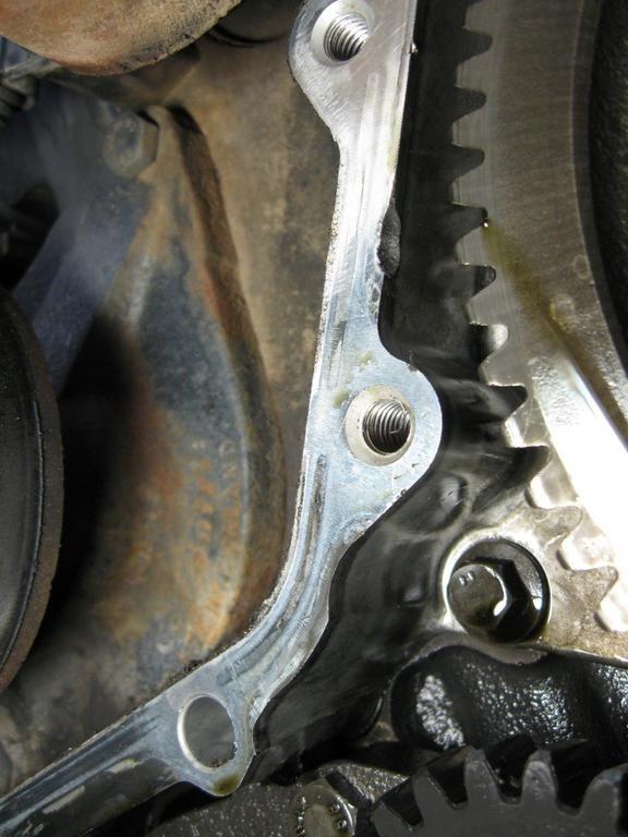

My father-in-law had similar luck. I went to check the KDP and this is what I found. Had about 200K on a 92 Dodge.
Looks like something tried to escape!

And I'm taking my new pin home tonight and back to its place of honor in my collection of what' dat stuff.
