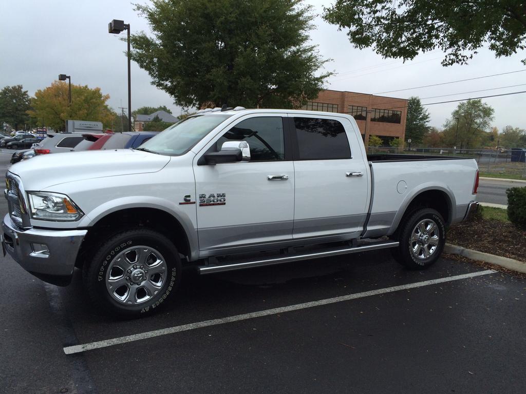

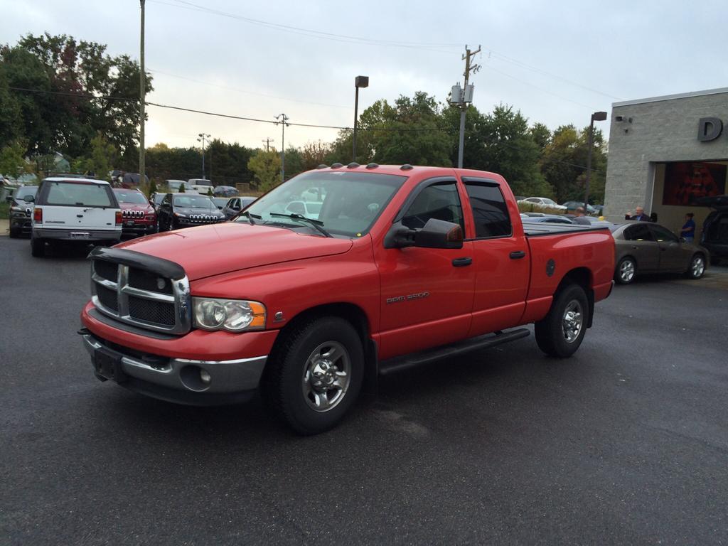

Just traded my 2003 2wd QC short for a 2014 4wd CC short!!
