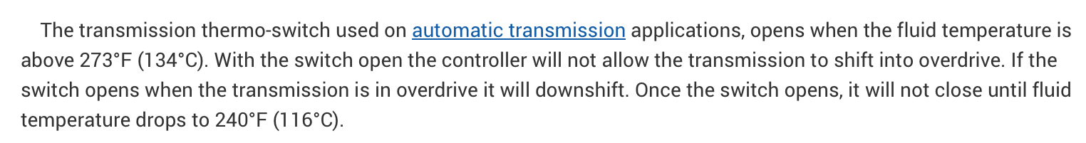

"check the trans overheat switch on the hot port out of the transmission, cant miss it, 2 orange wires... jumper that also"
Same, not sure what they mean by "jumper".

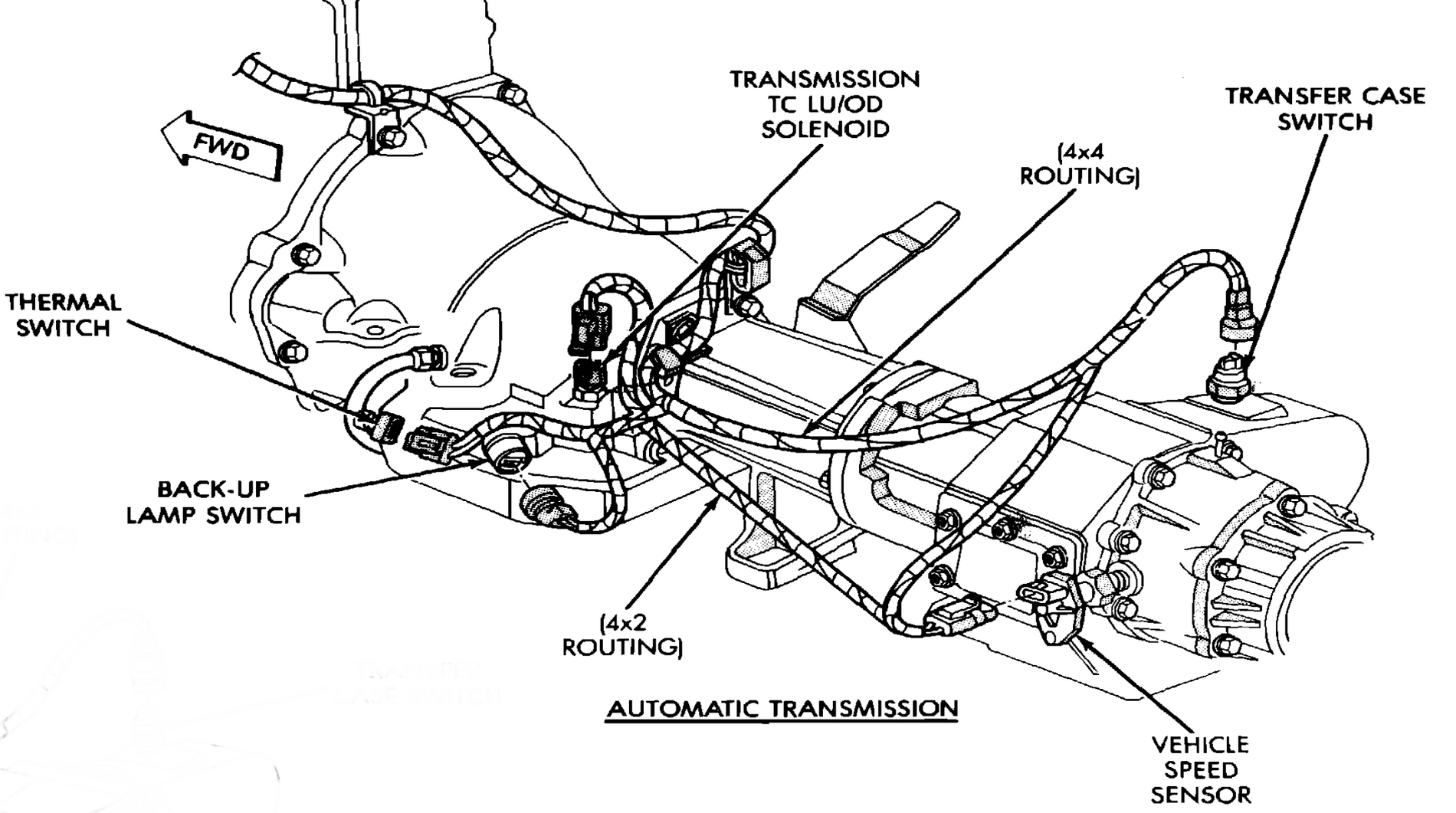

I was just looking at the sensors and wondering if you had an electric speedometer. I'm not too familiar with the 1993 system, when they converted from mechanical to electric. I found listings for the cable. Then at the bottom of the listing was a "related items" link to the sensors. Either way the signal may be causing issues with the related systems like cruise control and transmission shifting. Should be an easy fix. I see BigPapa's trans picture shows the sensor.

VSS is still available from NAPA, they have 3 different ones, and all 3 of them come with the pigtail.
