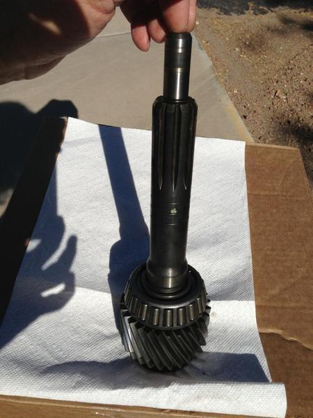

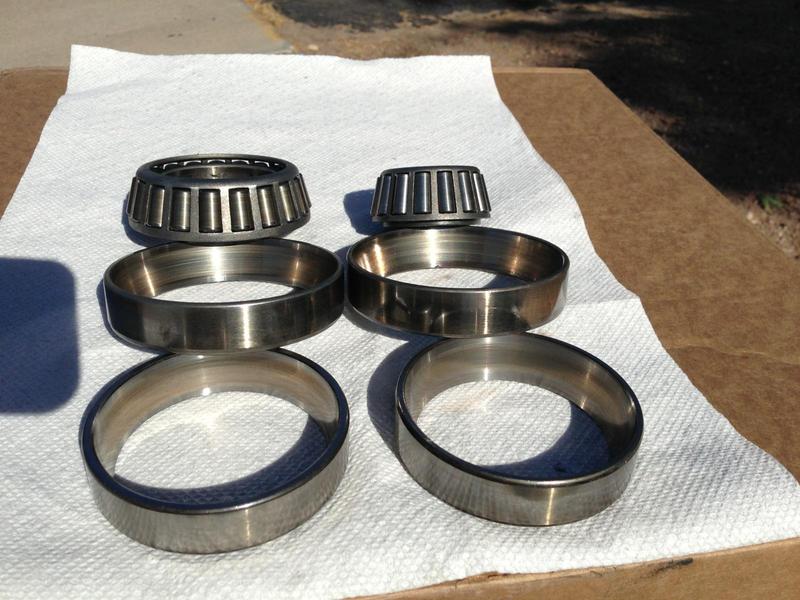

Its a little hard to see the brown on the bearings but the races tell a better story in the pictures. That is why you over fill it by one quart, and I strongly recommend you add the trans-cool's to the PTO in place of the PTO covers. Also, if you follow my threads in the very near future, I'm adding a trans cooler on the front of the radiator with a pump to help keep the G56 cool, heat kills this transmission quicker than a steel cased trans.
