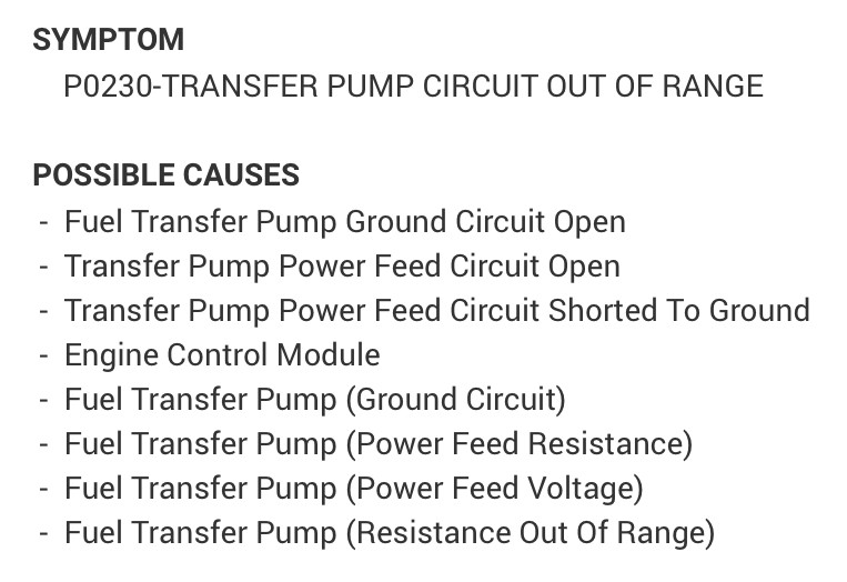

The truck will drive about 60 65 miles an hour any laboring of the engine causes black smoke p0230 Code.
Lift pump is running and I have 16 lb of pressure.
I tried to put this in the help for him but it would not let me post
I don't think the code and the condition match.

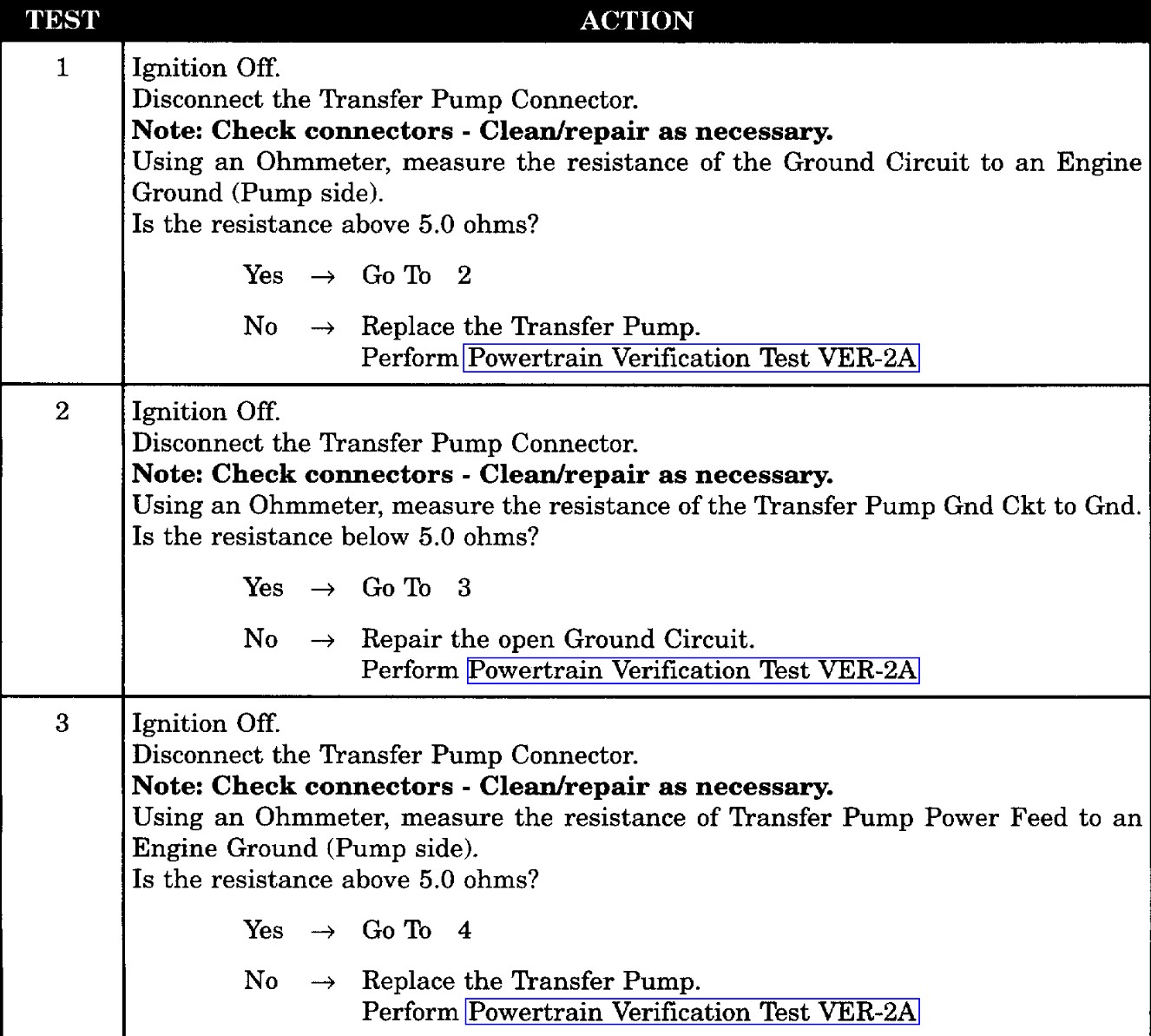

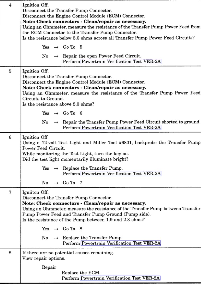

Code is electrical only but like you day your pump is running 16psi feed to the VP44.
Black smoke is to much fuel on to little of air.
How much boost do you get?
I do not have a boost Gage on the truck. I tow maybe twice a year.
Could it possibly be a plug fuel filters?
Your symptoms sound like you have a boost hose that’s come loose or has a hole in it.
Other than that, all I can do is post what the code is for and the tests.
