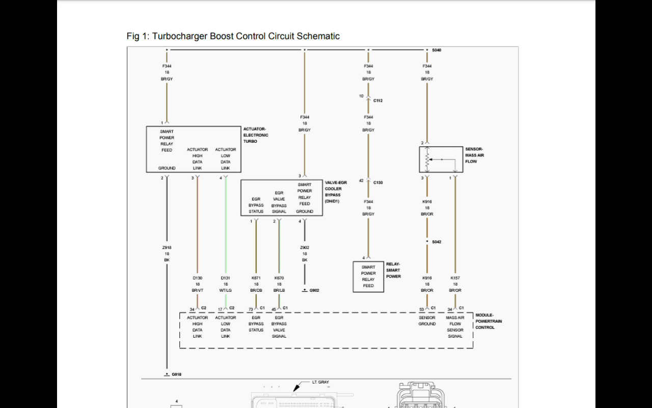

I had a close look at the wiring harness and the connector pins, all appear in very good shape. I measured 12v at pin #3 (key on, engine not running) on the connector. I removed and cleaned the soot off of the egr temp sensor, and egr pressure sensor. Put in a new air filter as well.
P245A came up almost immediately at engine start up after the BD manifold install. I drove the truck several times hoping that the system needed to adjust to the new manifold. The BD manifold internal geometry is slightly different from stock. After driving around code P245C also came up.
I did some other voltage checks on the connector: pin4 is ground. At key on (engine not running) measured 12v at pin3, at pin 2 the voltage jumps from 0.4v (key off) to 4.8v at key on. Pin 2 is the signal voltage from the ecm. At pin 1, which is the status signal from the egr valve motor to the ecm, the voltage is 12v constant at key on. I believe the ecm is looking for a return signal voltage between 5 to 8 volts at pin 1? I deduced that the egr cooler bypass motor is faulty. I am waiting on a used unit from a friend's garage that does deletes on dodge trucks. Hopefully this will solve my P245.
