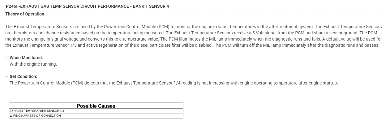

I did a search but did not come up with anything. Google does not come up with much of anything either. The truck in question is a 2011 6.7 cab and chassis, 100% stock with almost 70k on it. CEL is on and my code reader is giving me a P246F. Looks to be a egt sensor. Any insight to this one?

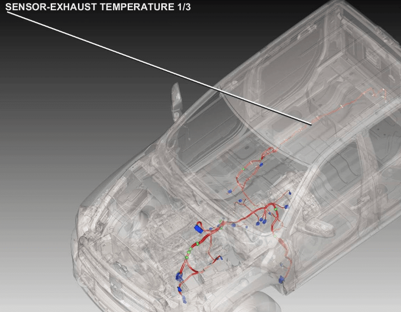

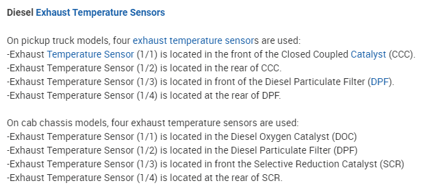

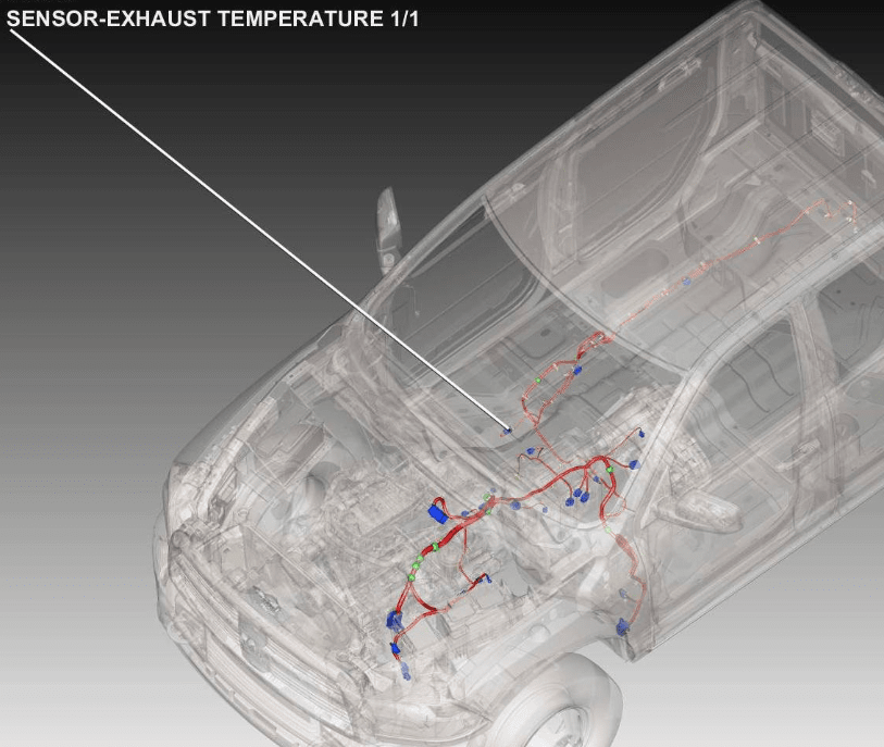

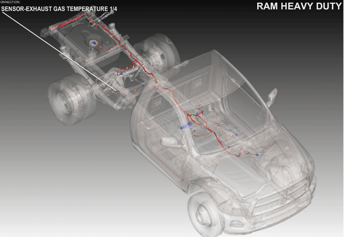

This is what Alldata shows.
These are actually CONNECTOR locations. I don't know how long the sensor wire is and where the sensor is actually located.
That’s perfect, thanks for the info. We had the #4 (rearmost) sensor replaced 2 weeks ago. Oh well, back it goes. I’ll up date with a final report of the root cause for future searches.
