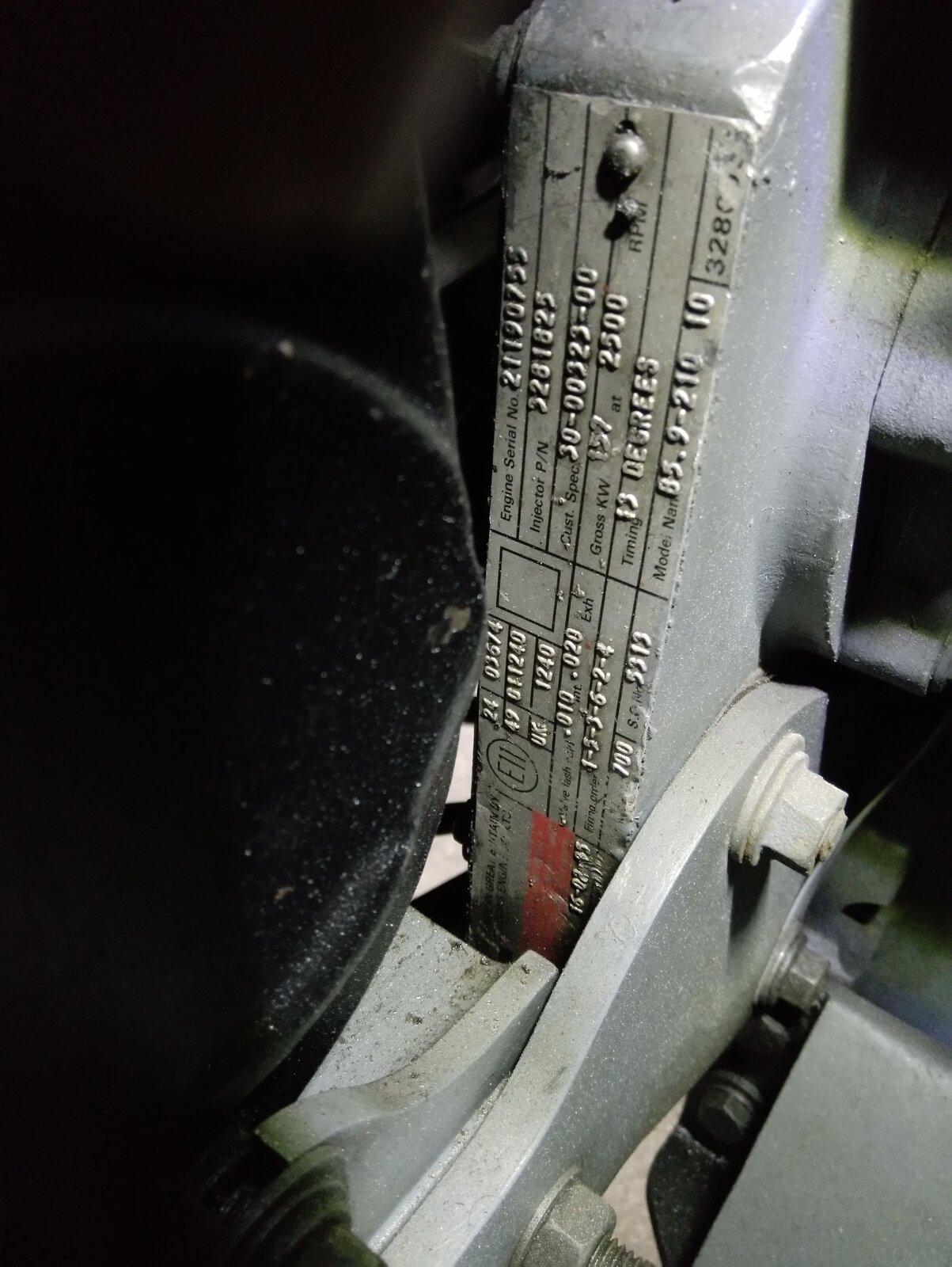

Hi, I think I got lucky with this, I've been looking around at a few engine data plates to try and match the cpl. Lucky for me I found one with the exact same cpl, pump part number, power output and everything. It's the same year and apart from actual ESN everything else is perfect match according to Cummins quickserve. On the plate it states timing is set to 13 degrees so I'm going to go with that as base mark and add accordingly using the degree wheel. I'm probably going to shoot for 15 degrees. My truck is a 91 suburban, zf5 manual trans with 0.76 5th and 3.54 axle gears turning 35 inch tyres. It's my daily driver go anywhere and do everything rig. I've just fitted new genuine cam and tappets, p-pump has 100 plate 3k GSK and modified AFC for more travel and control with longer spring. I'm just about to set up a new set of 5x10 injectors to around 280 bar, turbo is low mile stock Wh1c and gated to max 30-32 psi. In your opinion is 15 degrees about right for my setup? I know you are very respected on this forum and I remember reading posts years ago with content from you, i would love to hear your opinion on this for me.

5 X 10s are pretty small. Since you have a 100 plate I think 5 X 12s would be a better choice. But since you have them you can make the choice to go bigger any time. Timing, IMO, is engine driven. IOW, no one size fits all. My first foray into timing advances put me at 16. I hated it, too much lag for towing considering everything else was stock except my #11 plate. I experimented and finally settled on 15. What I'm saying is 15 is as good a place as any, but after driving it a bit you might go up or down and see how your engine responds at other settings.
Yeah 5x10 are only sat here be because I was offered them at a good price and they fitted my plan at the time, I paid £150 for 6 brand new genuine Bosch about 2 years ago. I never got around to fitting them and now plans have changed a little. I have all the shims needed and a pop tester so I'll get on with them and see how they run, I'm pretty certain a set of 5x12s will be finding there way to me in the future. I'm happy that you agree on the initial 15 degrees, I'm not really after a rocket ship or drag racer, I'm just after a solid reliable amount of power that can be used every day on the street. Thanks very much for taking the to me to advise me.
