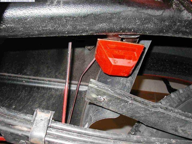

I keep going back and forth on the bump stop mod, I think it would be great when loaded but I am not sure how well it would work unloaded on bump roads.
My bump stops don't contact the spring at all unloaded, The Timbrens will contact the axle first. The bump stops contact the springs only when the 4,000-lb truck camper is loaded and the Timbrens are compressed. I don't know what the spring rate is on a 3500 SRW and don't know if the bump stops would contact when unloaded. For towing a travel trailer like yours, I wouldn't bother with the taller bump stops.
Bill
When unloaded, are you sure the bump stops would ever come on contact with the overload spring? Seems unlikely.
It wouldn't take much suspension cycling to contact at all, probably not too much around town but on back roads I wouldn't be shocked at all.

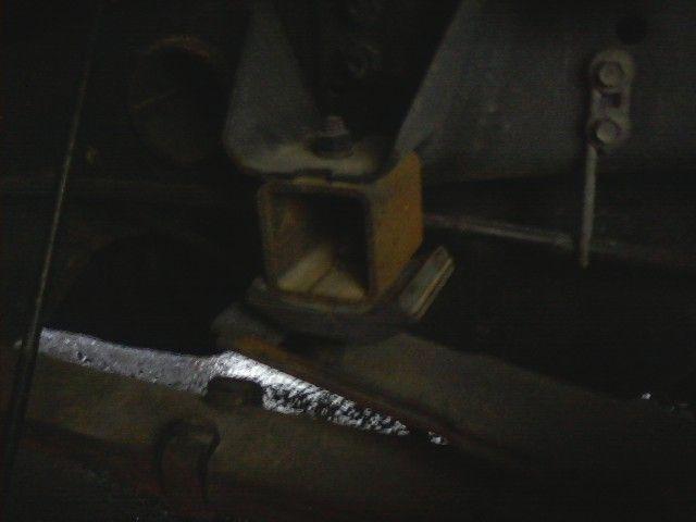

JJPage, thanks for the photo. That helps put it into perspective. Did you have to do anything to keep the square tubing from twisting or turning sideways?
When unloaded the overloads do engage once in a while, like a speed bump at Home Depot, and it gives quite a kick, especially to those in the backseat. But if I keep at least 15# in the bags it's not a problem. You could also experiment with different size tubing 1 3/4", 2 1/4" etc till you get it right for your application.
Dreamer, I didn't have to do anything special to keep from twisting, hasn't been an issue, I just cut the 2" tubing in 3" lengths to match the existing frame and pads and all is well.

Just as an update on this subject, I followed the advice given here and installed 1 1/2" square tubing, 3 inches long as JJPage suggested. Now the overloads engage earlier and support the load and reduced the side to side sway. Unloaded, there is about 1 to 1 1/2" of space before the overloads contact. This does create the odd bump/clunk when going over train tracks or speed bumps but I can live with that. Total cost was $10 for tubing and $6.00 for bolts. I have new Bilsteins ordered and will put them on soon.
