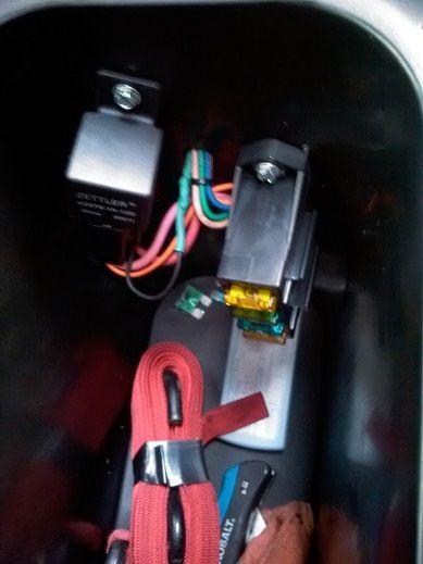

Not sure how you’re under hood fuse panel is set up, but on my 2013, the fuse for the rear seat cigar lighter has two places to be plugged in. You can have it always hot or triggered by ignition simply by moving the fuse to the left or right. I have my cigar plug hot all of the time, and trigger a solenoid for my switch panel plugged into the ignition circuit right next to the fuse.
