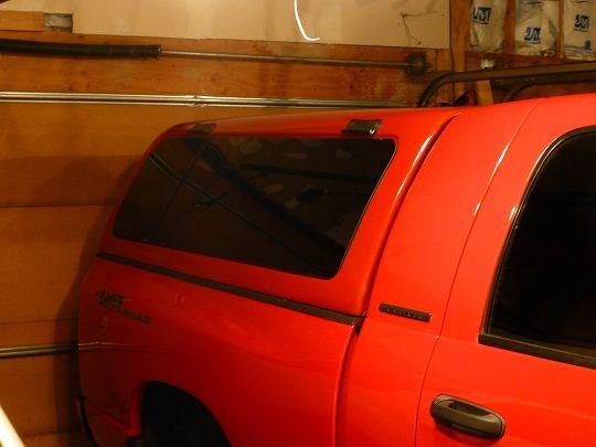

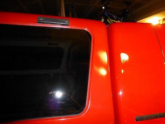

I painted mine myself using rattle cans and it has been perfect for 5 or more years now. I did the work in my garage, setting the cap on sawhorses. I just removed all hardware (for roof rack), sanded it lightly, masked it off and primed it (spray can). Then I bought out the whole city of Colorado Springs of color match paint (each auto parts store only had 2 cans each) and sprayed it. Then I used a clear coat spray (Rustoleum, I think) to finish it. Looks like a perfect match to my truck and like I said, has lasted a long time and still looks great. The hardest part was the masking job. Other than that it was done in 1 weekend.
That rattle can job looks great! But don't overlook Maaco! They were running a "bumper special", and the '98 needed one real bad. So I bought one from Sherman and brought it over. Gotta admit it came out real nice and is holding up well. Great paint match and they were good to deal with.
That was my experience with Maaco. I have had Maaco do body/paint work on my truck - repaired and repainted the bed sides - and I was happy with the work (and will go back in the future), but they would have been around $500-$600 to paint my top- so I did it myself. BTW, I used Duplicolor perfect match (https://duplicolor.com/product/perfect-match-premium-automotive-paint). My top was gold when I bought it on Craigslist for $600 (and it included a yakima rack and accessories).
