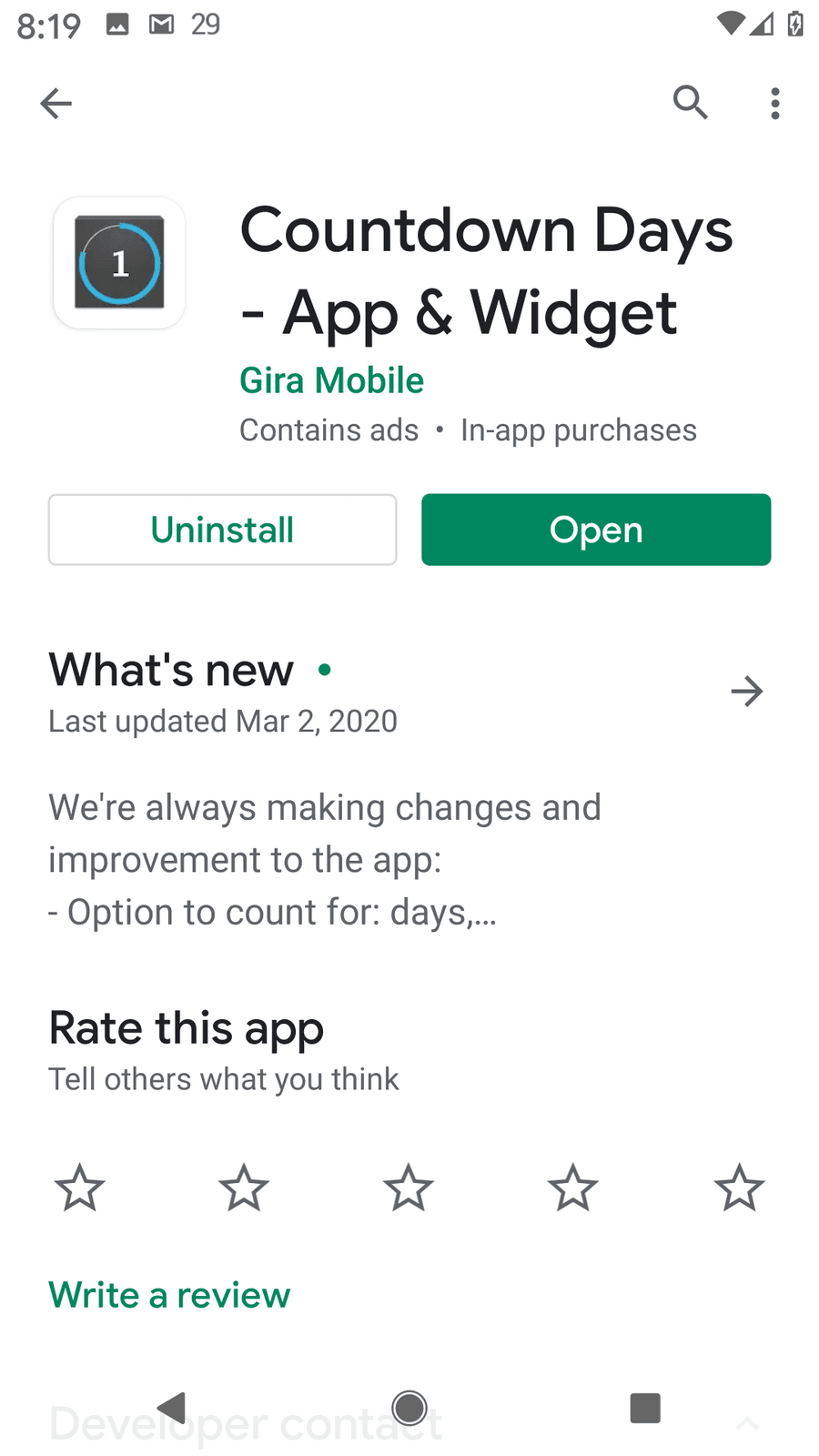

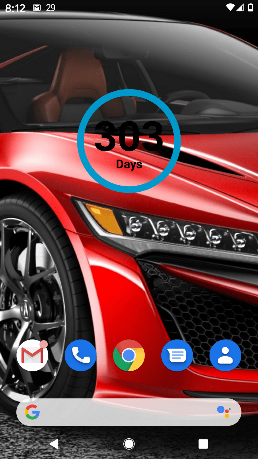

I have an app that counts down the days left in the year.
