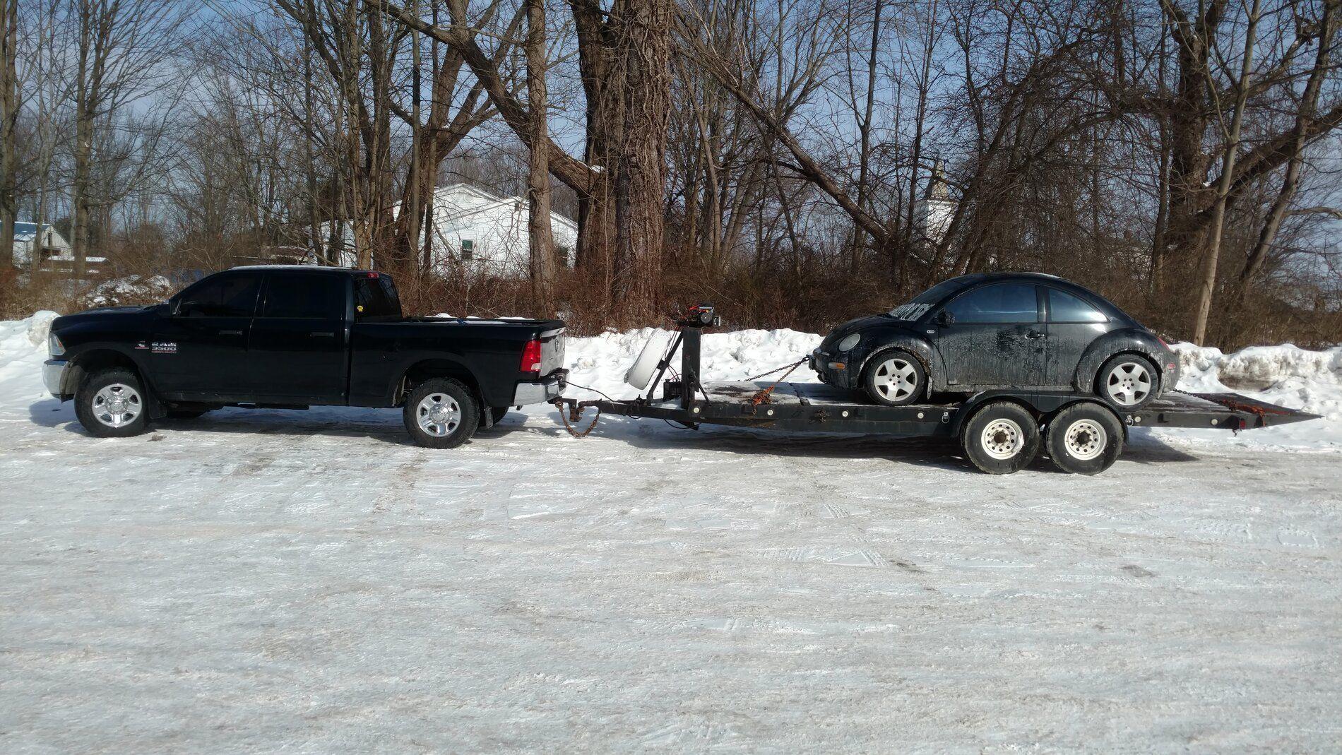

Its the milder climates that have large swings with brief cold weather that have the issues. If you look up ASTM's website for winterized ULSD, it's worded something like 3 of the average coldest days of 30. It's NOT a requirement either - only a guideline. Its a big game of minimal additives to prevent problems vs keeping costs down and sometimes they get it wrong . I have fuel delivered to the house and haven't had a problem with the company I buy from in more years than I can remember. Most of their customers are Ag and commercial. The wife filled her car up south of here about 100 miles the last cold snap we had and her car gelled up the next day. It barely hit 10 below zero. Even though I had to do the leg work (driving out to get her and load it on the trailer) it reinforced what I have been preaching to her all these years - fill up BEFORE you leave home! The proof was in the tank - my truck had no problems.
