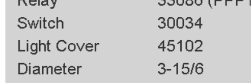

If it includes its own relay, then that's the way to go. According to the web page it comes with a relay AND a switch. You most likely can wire it up still to use the stock switch even if the included instructions don't show you that option.
However, if you want to be able to turn the fogs separate from the spots, you might want additional switches.
Got both light sets today, they came with a very generous and well made wiring harness(with relay and switch) but the instruction manual is leaving a lot to be desired.
Instruction manual says 3amp max for the inline fuse on the harness, I check both harnesses and I'm looking at a 30amp. The harness doesn't have a wiring diagram either so I'll have to cut one open and map a color key. They made it very easy and straight forward to add lights and run a harness; just power, ground, and mount the switch.

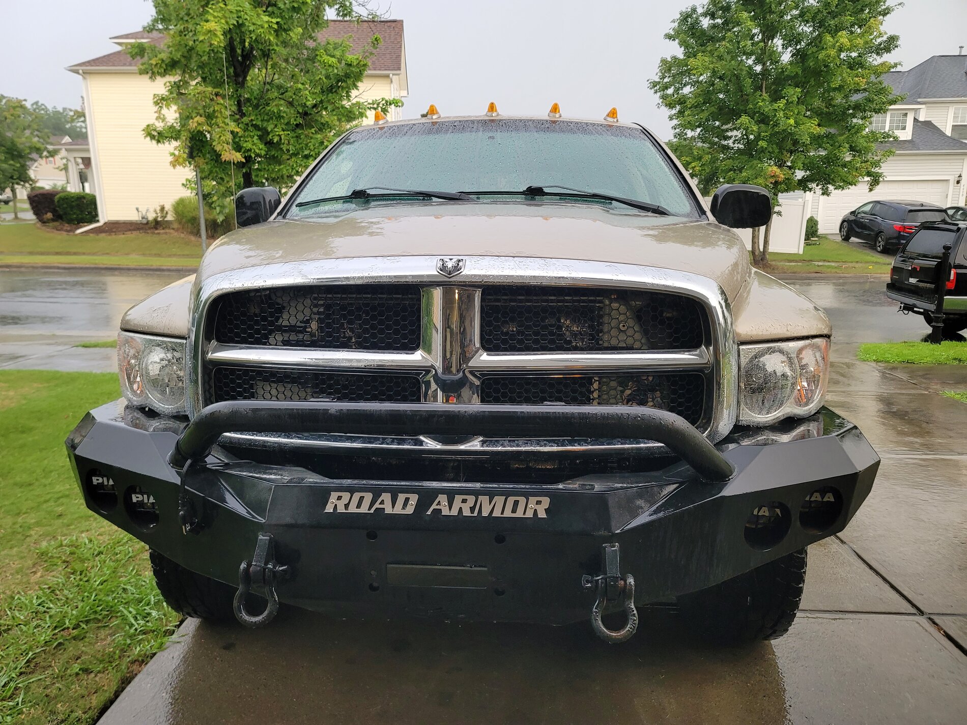

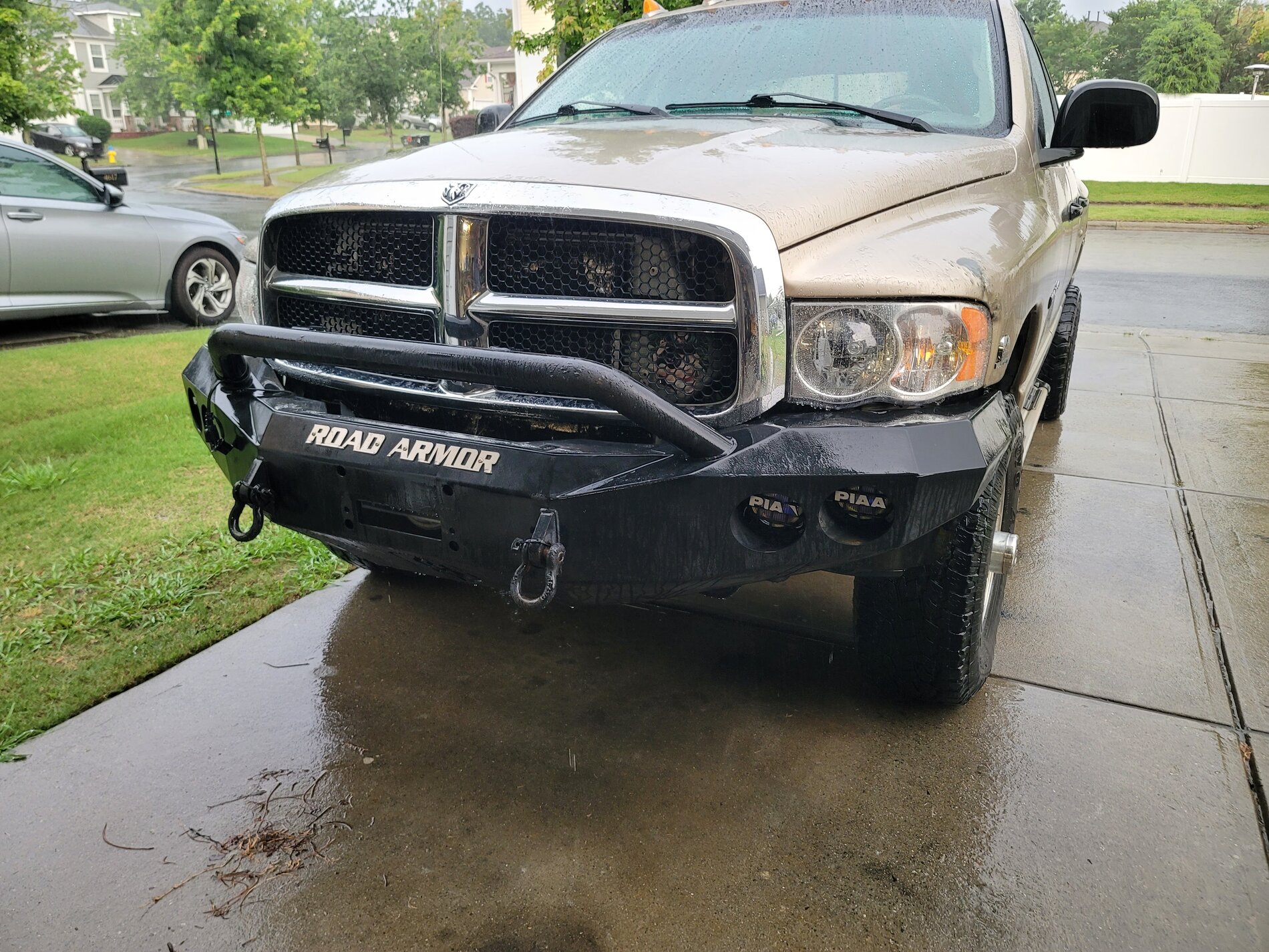

No issues, no fires. Used the OEM lamp harness. It took longer to route the OE harness given it's length. I still have amber light covers in case I get pulled for them being too bright, but they're aimed pretty well.
Hard to tell from the images (how tall is that tree?) but those look as much a driving light pattern as fog. My fogs (PIAA, Bosch, Hella) all have a clear cutoff along the top that is no higher than the lamp, substantially more beam width than shown, and can be used with oncoming traffic no issues. Again, all speculation since I don't know the geography in front of the truck here,

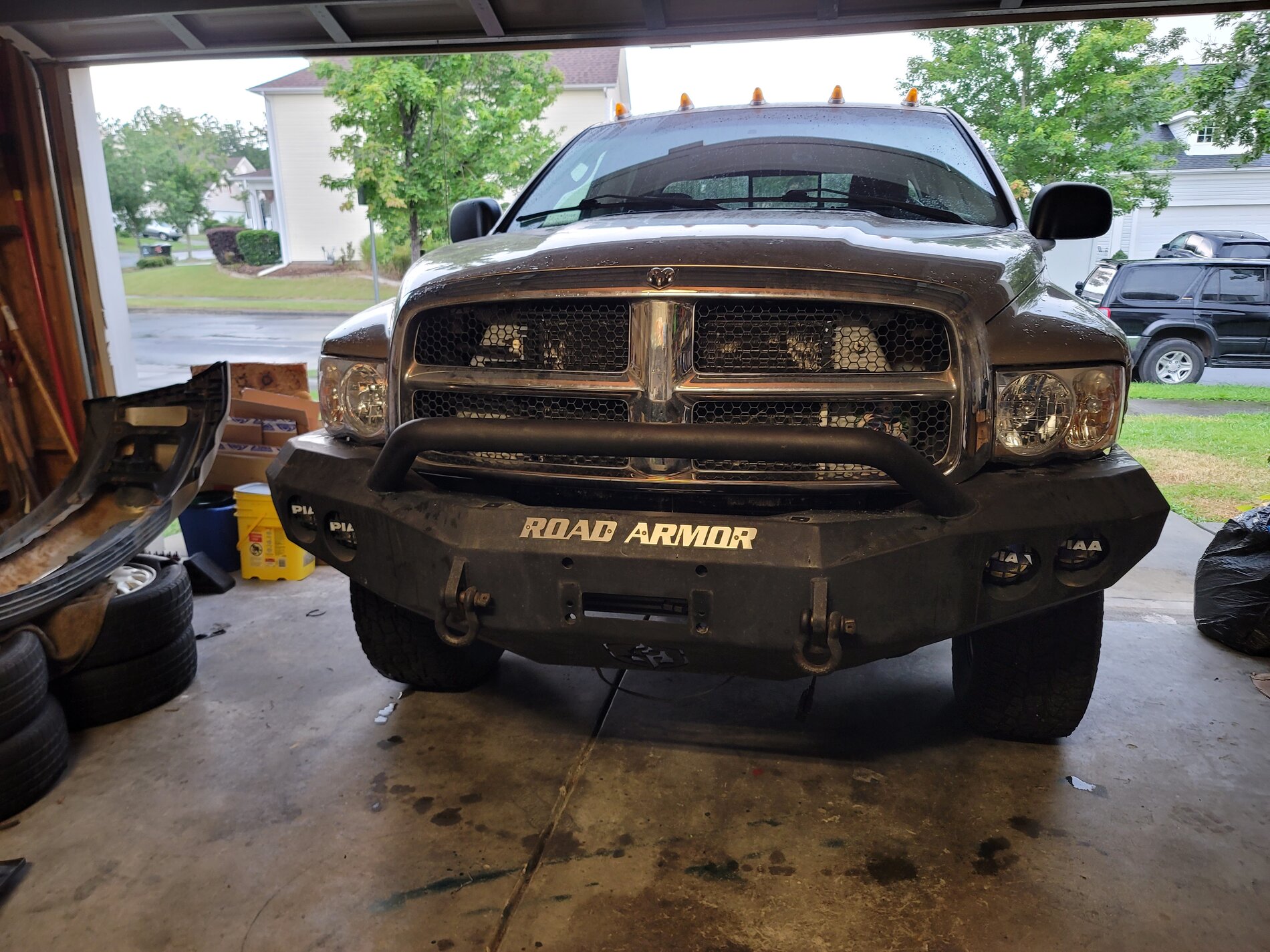

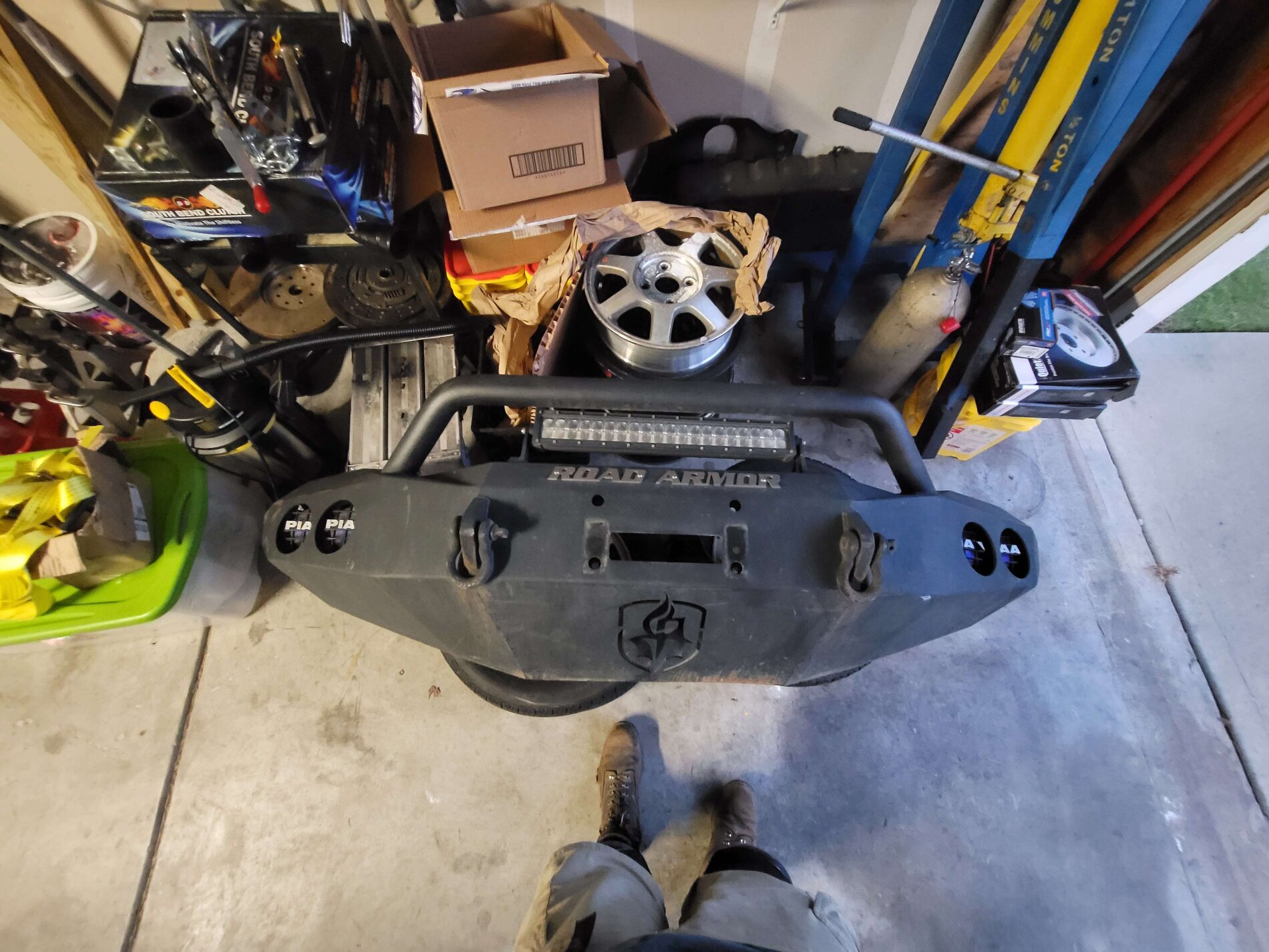

Fogs on the outer, spots on the inner. They do sit fairly recessed in the bumper so the fog beam isn't as wide. For the light output and better visibility im getting I can live with it.
