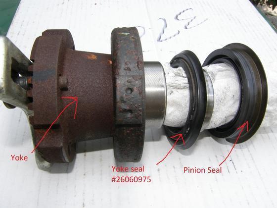

I had a small leak I thought I would take care of today. Picked up a new pinion seal and proceeded to take it apart. After getting into it I see there's really 2 seals. A pinion seal and a seal that's on the yoke. Well, the one on the yoke had a groove in it so I thought I'd pull it and go get another one. To my surprise, dealer doesn't sell it and no local part stores could find it either. Dodge says i need to buy a whole yoke at $160 to get the seal (already on it). I guess they decided to sell only the assembly. What a load of BS... anyway, i need to find just the seal.
He's a pic...
I've googled the part # on the seal (26060975) and found at least one place that sells it but I don't know anything about them. Can anyone recommend another place to get it?
http://www.drivetrainamerica.com/p-4186-26060975-pinion-flange-sleeve-seal-gm-86-aam-925. aspx
