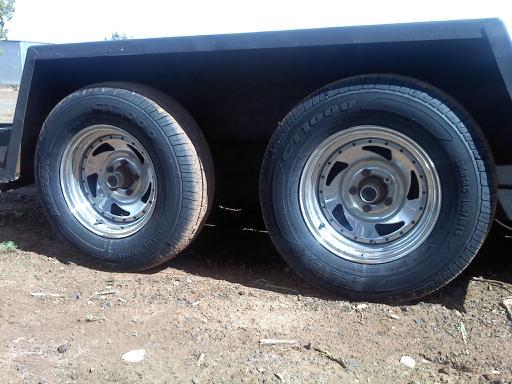

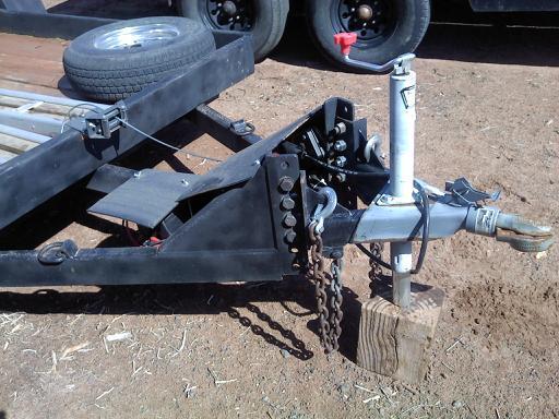

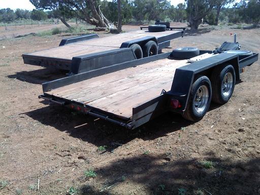

Hey Nick, what trailer are you referring to when you say you have to be careful pulling into McDonald's? What configuration is it? Deck, axles, etc.
I didn't realize you were specifically looking for a deck over trailer, even with torsion axles you should be fine with clearance. Especially in a tilt bed as they typically have a straight deck without a beaver tail. My deck over trailer with springs and 5' beaver tail still requires careful crossings of dips. My low deck car hauler types can be a pain off highway.
This is my lowest deck trailer and one I have to be extra careful with, it's only 14' with a short overhang but with torsion axles and 14" tires it is really low, nice for loading my little Bobcat tho.
