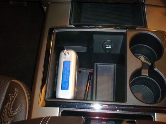

Just an update. Installed the MaxBrake controller last night. I have a 2012 2500 crew cab, automatic, ST trim level.
We used a small bracket from something else that had a ninety degree bend in it to mount the hydraulic pressure sensor on; the bracket is mounted with one of the bolt/nuts that secure the brake master cylinder to its bracket. The "tee" fitting that came with the kit would only work on the back port of the master cylinder - would not fit the front port. Three tee fitting came with the kit - I am to send the two I did not use back - but it caused a momemnt of consternation when none of the three tee fitting worked on the front port of the master cylinder. Took some patience to bend the new brake line to curl around and meet the sensor. I used a piece of shrink wrap over the whole sensor plug to keep moisture out of the plug in the future.
The instructions don't explain this, but it made perfect sense when it was explained to me: the brake master cylinder is at the highest point of the braking system so air will not go down in the lines when one line is removed from the master cylinder. There is a check valve that keeps fluid from flowing out/air flowing in to the master cylinder with a line unhooked. So, it really is OK to bleed only at the top of the system. We were really cautious and bled at the master cylinder entry, the new tee fitting, and also at the pressure sensor fitting. That was probably more than necessary, but I think it is better to be safe than sorry with brake issues.
There is a nice rubber boot to feed the sensor cable through and into the cab right above the parking brake pedal - a small slice with a razor knife and a little rubber cement to seal afterward took care of that.
The sensor cable was easy to snake under the dash and out a little rectangular opening already in the middle of the console area - right under the temperatire controls. The wiring bundle required a little more patience as the rectangular opening was almost the same size as the plug. Used a number of zip ties to locate the wire runs way up under the dash so there will be no chance of falling down into the pedal area and causing a problem.
The dash plastic in the middle has a nice slant to it that allowed for mounting the controller right in the middle at a neat angle - really easy to read the screen and really easy to reach.
Read the manual and did the calibration; it won't be tested for real until the drive to the TDR CMEP gathering next week.
I think the kit for the installation of the MaxBrake controller could be better: it could come with a mounting bracket, bent hydraulic line, proper tee fitting, etc. , as well as suggested cable routings for the truck you have. This would save installation time. I know nothing about what this would mean to the vendor - just that the product installation would be much improved if it worked that way. If you are going to get the MaxBrake then plan to spend some time on figuring out the mounting bracket for the pressure sensor, sorting out the tee fitting, bending the hydraulic line, routing cables, etc.
I note that some said the controller itself was not visually appealing - beauty is in the eye of the beholder - I think it looks good sitting there.
My fitting fit the front brake line port. I probably had an advantage on that note because Dutch and Di were right there and we picked the one that fit. I put a nice gradual bend in the brake line with the sensor on the end and zip tide it down. Looks good and is solid.
I really like what you did and will probably copy - nice job and pictures! I would also like any information on the wiring you did so that the EVIC message was not coming up. I have read numerous posts but since we both have the same exact trucks I would appreciate your comments.

I did get mine from the great folks at Plug it Right. As far as wiring, the 12 has the standard brake controller pig tail, so no modifications are required. I took my 12 to the dealer and they reflashed it to remove the factory brake controller from the EVIC.
I think others here have devised a simple cross wire technique to eliminate and nuisance messages.
