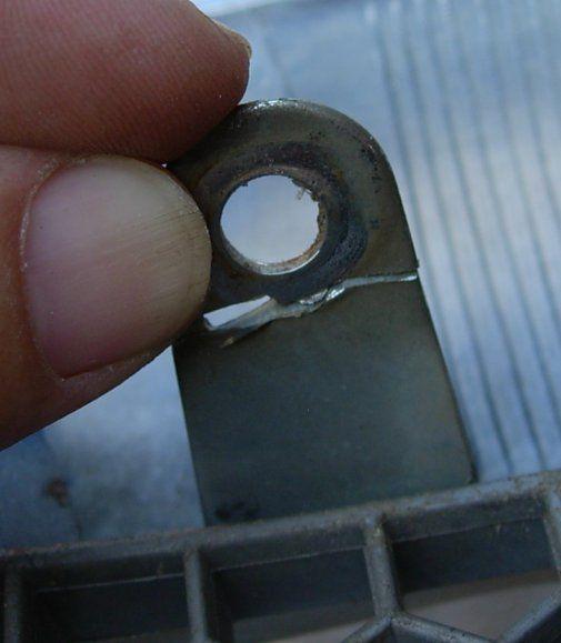

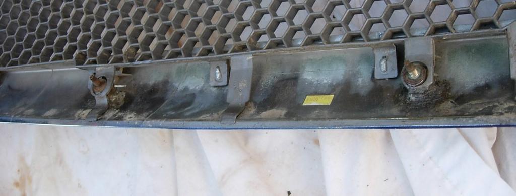

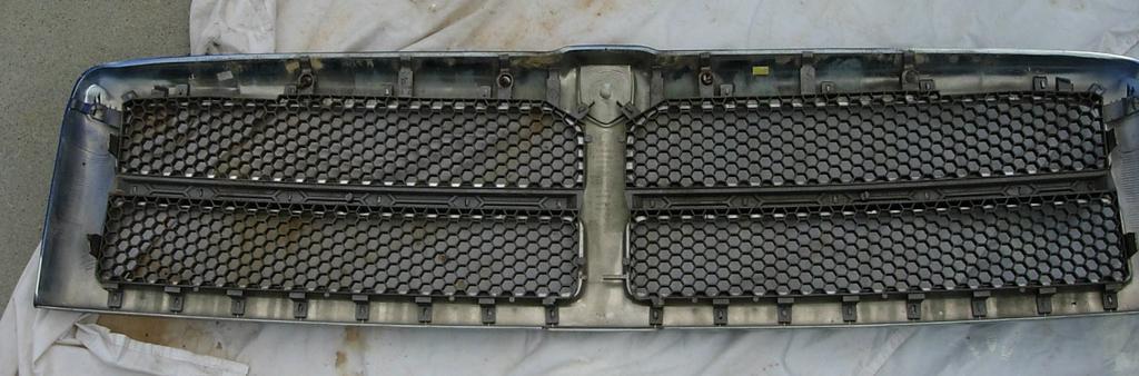

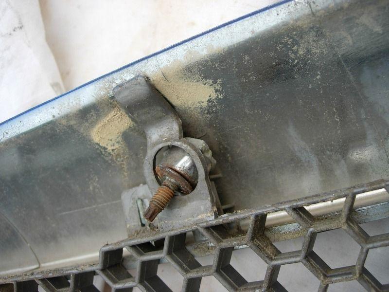

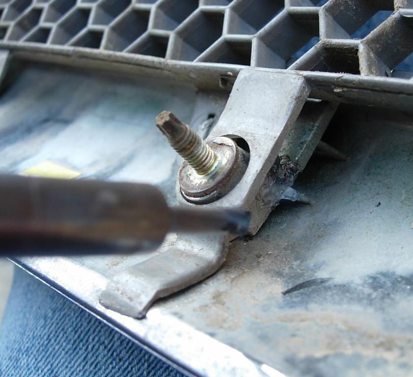

My grill hung on simply because the broken mounts hadn't completely escaped their encapsulated position. It was time to fix it. By my count, there are 11 places where the grill secures itself to the hood & the [sorry for the poor nomenclature here:] rectangular metal skeleton which houses the hood release mechanism. 8 metal fasteners remain for me - none attached.

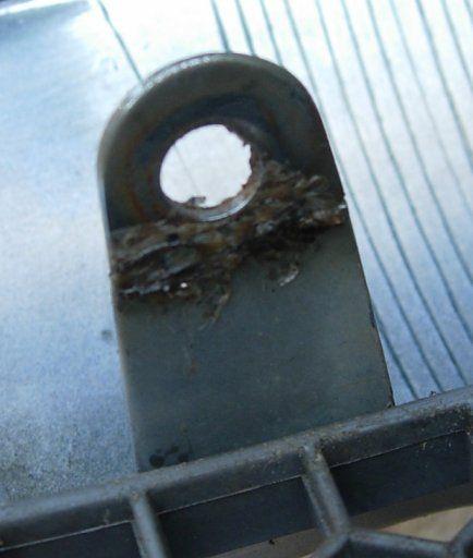

I used my low watt soldering iron to melt them back together. It worked well. When I needed extra plastic to fill in gaps, I used the chunk of plastic I cut from the A-pillar.

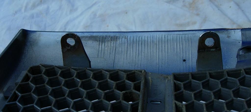

The side tabs which connect to that metal skeleton acted a bit differently than the ones attached to the hood. The chrome paint didn't melt, so I couldn't get much plastic penetration. Nonetheless, they seemed alright.
Upon reattaching, one tab on each side of the grill cracked. The remaining 6 fasteners work well, and I'm happy to say she feels solid!
Of note, I "welded" one of the hood fasteners a little bit off center [it still fits], so if you choose to repair your grill, ensure you "weld" those pieces upright.
Cheers!
