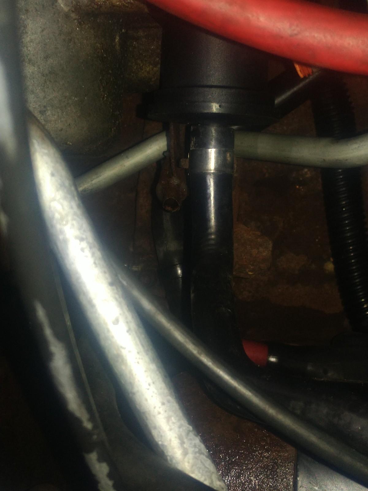

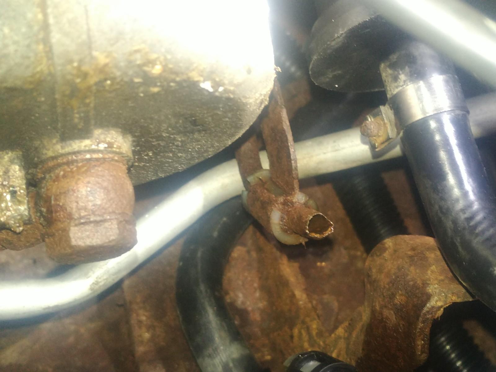

Hey guys I'm just wrapping up installing a new radiator and mishimoto trans cooler on my 2004.5 Cummins and I started the truck went to fill the coolant and saw a diesel pouring out of what I noticed looks like a fuel return line? I will try and post photos but I wouldn't even know where to begin

Suppose you can get that out of there and not ruin the plastic quick connect? If your luck is like mine then probably not….

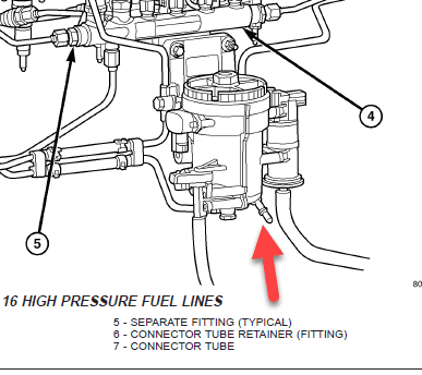

I'm going with # 11. This would be the supply line connection.

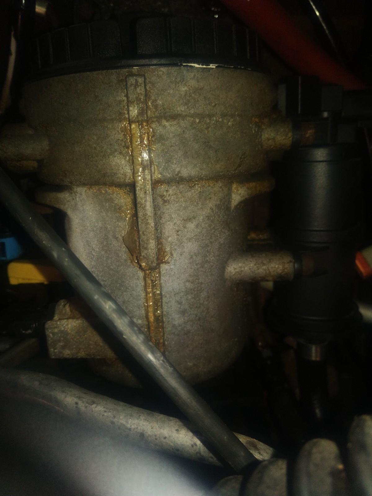

If it connects to the fuel filter housing this is the one. It's kinda' hard to tell from the picture...

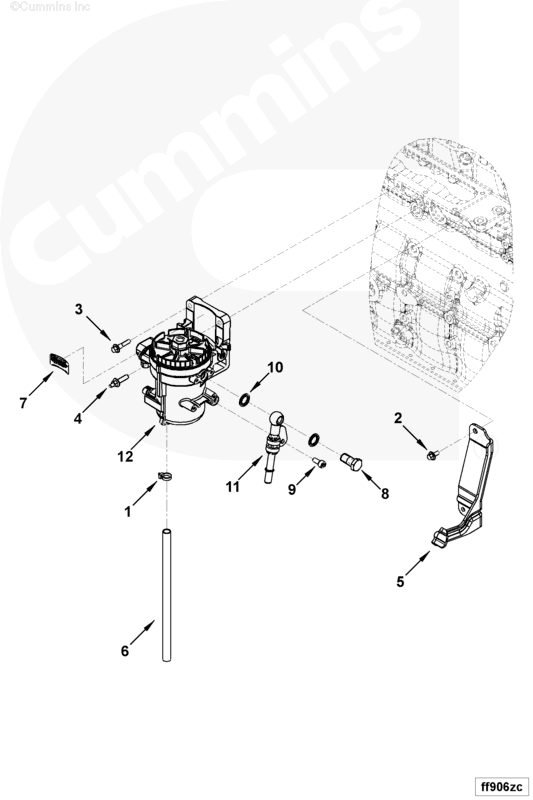

Cummins Part # 3973915. I'm not blocked, if it were RAM only I would not be able to put it into my order.
The PDC in Harrisburg Pa shows them on hand.

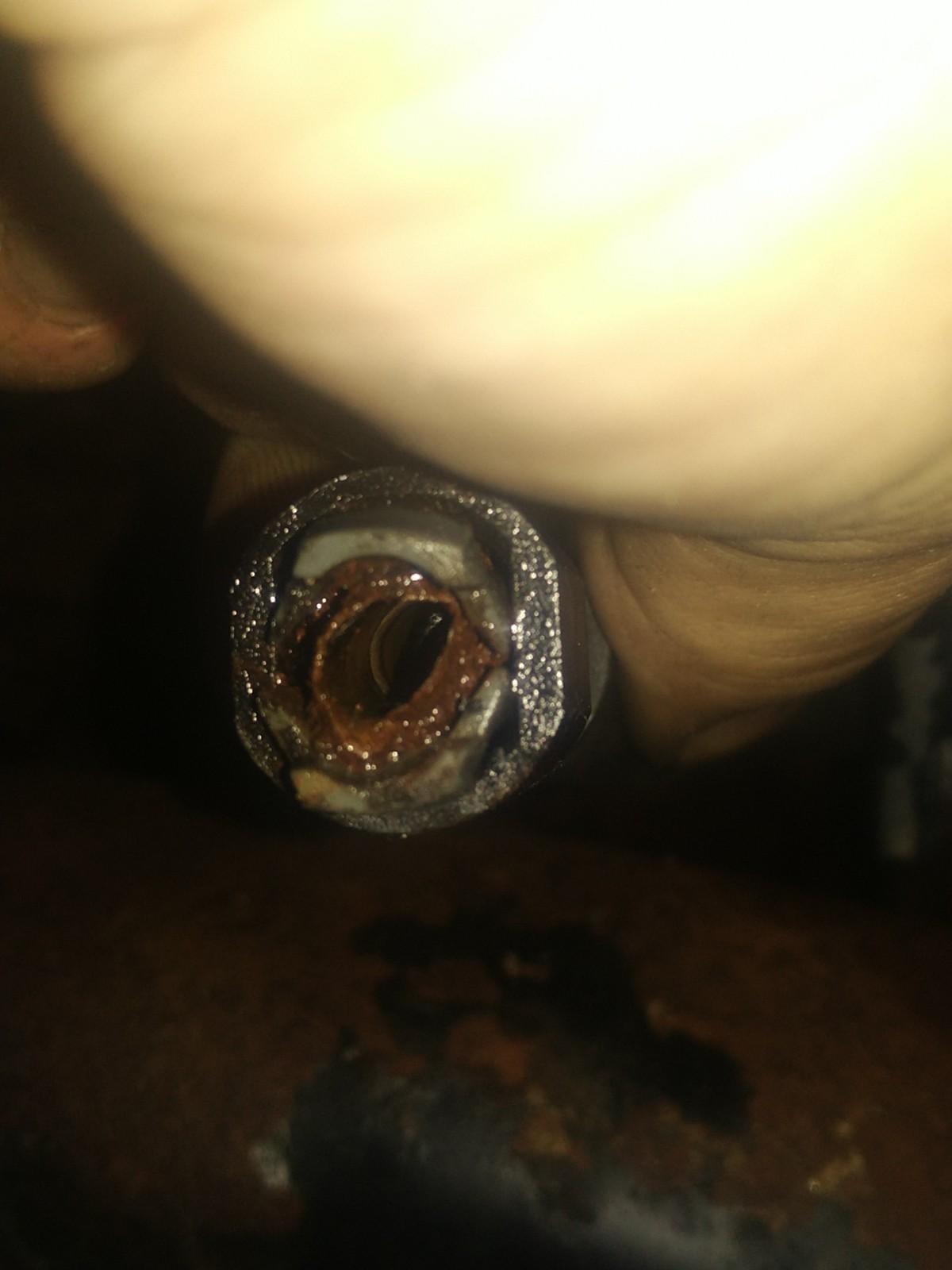

The tricky part is going to be saving the plastic quick connect. It can be done with patience. I have saved those time after time, you have to get the crap flushed out of it so the plastic release tabs will squeeze inward. PB Blaster or WD-40 will do it.
For the benefit of all, the part he needs appears to be the return line in post #5. The Chrysler PN is 5093088AA and it is available from the dealer or Geno's.
Quick disconnect repair kits are available at most Napa stores.
